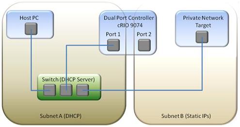

    1. Configure the host PC, dual port controller, and private network target as shown in Figure 1 below
    Figure 1. Set-up configuration

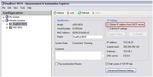

    1. Open Measurement & Automation Explorer (MAX) on the host PC. Both LabVIEW Real-Time targets should be visible in MAX under Remote Systems (see below). If a LabVIEW Real-Time target does not appear in MAX, enable the IP RESET DIP switch on the controller, reboot the controller, and then disable the IP RESET DIP switch. This will reset the IP address to 0.0.0.0.
    1. Select the dual port controller under Remote Systems. Ensure that Obtain IP address from DHCP server is selected in the IP Settings field. If Obtain IP address from DHCP server is not selected, select it and click Apply. Click Yes to reboot the controller. Wait for the controller to reboot.
    1. Repeat step 3 for the private network target.

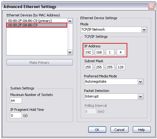

    2. Select the dual port controller and click on Advanced Ethernet Settings to launch the configuration window.
    3. Select the MAC address of the secondary port. The IP Address field is the IP address of the secondary port on the dual port controller. This IP address is static and must not reside in the subnet of the primary port.
    1. Set the IP Address and click OK.

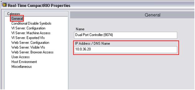

    1. Open Dual Ethernet Ports on RT.lvproj  in LabVIEW 8.5 or later, on the host PC.
    2. In the project, right-click on Dual Port Controller and select Properties. Select General from the left menu, enter the IP address of the dual port LabVIEW Real-Time controller. Click OK.
    1. Repeat step 2 for Private Network Target.

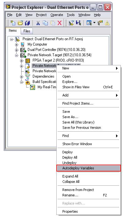

    4. In the project, right-click on Private Network Target SVs and ensure that Autodeply Variables is not checked as seen below.
    1. In the project, right-click on Private Network Target SVs and select Deploy. This will deploy the library of Shared Variable to the controller.

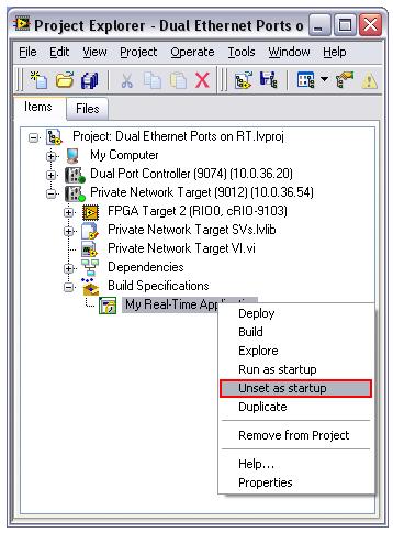

    2. Expand Build Specifications under the Private Network Target.
    3. Right-click on My Real-Time Application and ensure that the application is set as startup (Unset as startup will be present as shown below).
    1. Right-click on My Real-Time Application and select Deploy. This will deploy the startup application to the controller.

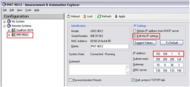

    1. Open MAX and select the private network target under Remote Systems.
    2. Select Edit the IP settings in the IP Settings field. Enter an IP address that resides in the same subnet as the secondary port of the dual Ethernet port controller (i.e. 192.168.1.5).
    1. Click Apply. Click OK on all dialog boxes and Yes to reboot.  You have now configured the system as shown below. (Note: The host PC will most likely lose all ability to communicate with the private network target. This behavior is expected, since the private network target is on a different subnet. Useful Tip: To maintain communication with both targets, use a second NIC in your development machine, configured with a static IP that resides in the same subnet as the private network target.)

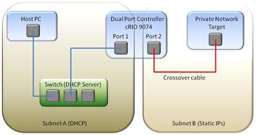

    1. Disconnect the private network target from the switch or hub.
    2. Now connect the private network target directly to Ethernet port 2 of the dual port controller, using a crossover cable as seen below in Figure 2.
    Figure 2. Deployment Configuration
    1. Reboot the private network target to run the startup application.
