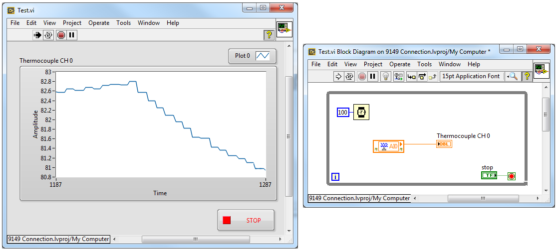

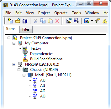

  2. Open LabVIEW and create a new project. In the project, add the NI 9149 (Figure 3) and create a new VI (Test VI.vi) under My Computer to begin acquiring data as seen in Figure 4. You must deploy the NI 9149 before connecting it to the secondary port of the real-time controller. Deploy the NI 9149 from the project by right-clicking the NI 9149 and selecting Deploy All. If you do not deploy the NI 9149 before connecting to the secondary port, the host PC will not recognize the NI 9149.
Figure 3. LabVIEW Project With NI 9149 and NI 9211
Figure 4. Block Diagram and Front Panel of Data Acquisition

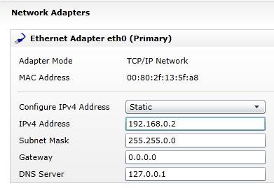

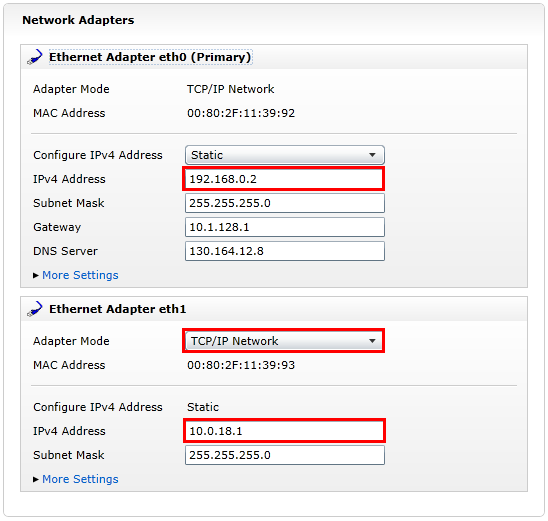

  3. Select the cRIO-9074 under Remote Systems. Ensure that Static is selected for Ethernet Adapter eth0 (Primary) under the Network Settings tab. The Primary Ethernet Adapter refers to the primary Network Interface Controller (NIC) on the cRIO-9074. Set the primary NIC to a static IP (192.168.0.2) as seen in Figure 5.
  4. Set the secondary NIC of cRIO-9074 to a static IP address. To change the IP address of the secondary NIC on the cRIO-9074, go to the Network Settings tab in MAX (also seen in Figure 5). This example uses 10.0.18.1 for the IP address of the secondary NIC.
Figure 5. Configure Secondary NIC

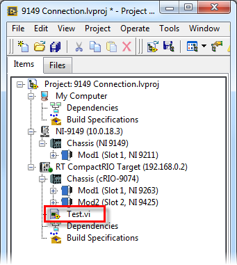

  2. In the project explorer, drag the VI you created in earlier (Test VI.vi) from My Computer to underneath the cRIO-9074 target as illustrated in Figure 6. You will need to update the IP address of the NI 9149 in the LabVIEW project to the new IP address you gave it. Do this by right-clicking the NI 9149 in the project and selecting to Properties. In the configuration window, you can change the IP address under General » IP Address/DNS name.

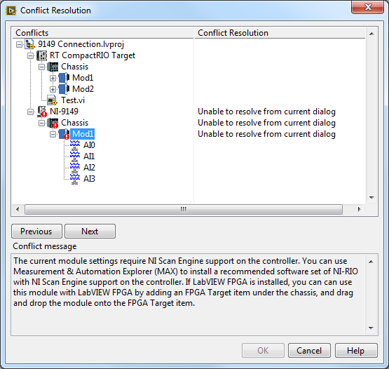

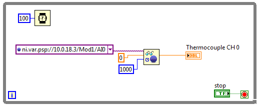

  1. When you run Test VI.vi under its new target—the cRIO-9074—you will receive the error shown in Figure 7. This error states that you do not have Scan Mode installed on the NI 9149, but you already installed Scan Mode. This error occurs because the IP address of the NI 9149 was changed to a different IP address and subnet. The static node used in Figure 4 maintains the original IP assigned to the NI 9149. Because you changed the IP to a different subnet, you must change your code to use the Programmatic Shared Variable API. Using the code shown in Figure 9, you can communicate with your Ethernet RIO expansion chassis.
Figure 7. Requires Scan Mode
  1. To set up the VI in Figure 8 correctly, you need to use the correct Shared Variable API VI. This example uses the Read Variable with Timeout function, which can be found in the Functions Palette under Data Communication » Shared Variable » PSP Variable » Read Variable with Timeout.
Figure 8. Block Diagram for Shared Variable API
