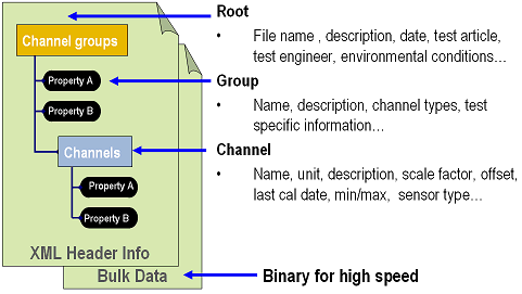

The TDM file format specifies that descriptive information such as comments, units, and channel names are saved in a header file with the extension TDM, while the measurement, simulation or analysis results are saved in one or more binary file(s). The TDM and binary files are linked through references that are created automatically when using the LabWindows/CVI DIAdem Connectivity Library, LabVIEW Data Storage VIs, or programmatically when using the TDM Header Writer C API.
TDM files use XML to manage and structure all the descriptive information contained in the TDM header file. Each TDM file contains descriptive information on three different levels – the root, group, and channel, as illustrated in Figure 1.
Figure 1. Hierarchical Structure of a TDM File
One TDM Root object, also referred to as file, can contain several Groups, and each group can contain several Channels. The TDM data model has a defined set of properties at each of the three levels while also providing functionality for you to insert your own custom properties.
The descriptive information located in the TDM header file is a key benefit of this format because it provides an easy way to document your data without having to design a custom header structure. As your measurement requirements grow, you do not have to redesign your application; you simply extend the TDM data model to meet your expanding needs.

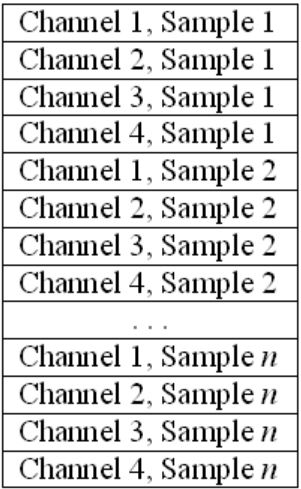

One of the great advantages of TDM header files is that they can describe many different types of data sets. The most common use-case for TDM header files is documenting binary data acquired from multiple channels.
In order to link data from multiple channels in a single binary file to a TDM header, the channel data must be stored either end to end or interleaved. The most common case is data from multiple channels stored in a single, interleaved binary block. This binary block will not only be described by its length, the number of samples per channel, but also by its width, the number of bytes containing one sample for all channels. Figure 3 illustrates the structure of a binary file containing four channels and n samples.
Figure 3. Structure of an Interleaved Binary Block
In this case the binary block length is n. If the data type of all of the channels was an 8-byte double-precision floating-point, the block width would be 32 bytes. Note that the channels in the same binary block may be stored with differing data types. Note also that the channels must be consistently interleaved in consecutive order.
One of the most common ways of acquiring data from multiple channels using C is to use the DAQmxReadAnalogF64 function of the NI-DAQmx C API. The DAQmxReadAnalogF64 function can output data both end-to-end and interleaved. The output formatting is set to interleaved by the inputing a value of DAQmx_Val_GroupByScanNumber to the Fill_Mode parameter of the function. In the following example we will acquire 25 samples from each of four channels using the NI-DAQmx C API in LabWindows/CVI and save them to a binary file in interleaved format. (Note: TDM header files describing binary files in interleaved format can be read only in LabVIEW versions 8 or later and DIAdem version 9.1 SP2 or later.).
