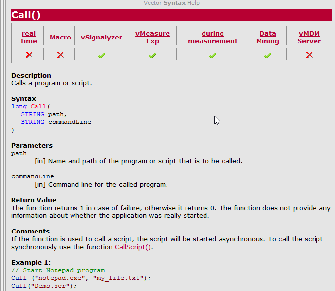

  • If you are able to build your LabVIEW code into an executable, then you can call that executable in CANape using the CANape call() function. CANape's call function allows you to call a program or script with the program's path, and pass command line arguments to it. More information on the call() function can be found below.
In order to use your LabVIEW code via the CANape call() program, you will need to build your program into an executable and, if you need to pass initial values or commands to your code, configure it to accept command line arguments by using the Application.Command Line Arguments property node and configuring your build specification to pass command line arguments to the program.
