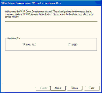

The wizard first prompts you for the device's bus type. Select PXI/PCI as shown in Figure 2.

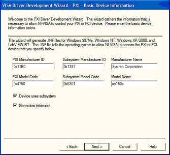

Device Information
The PCI bus specification requires unique manufacturer and model codes to be embedded into each device. This information is used by the system to identify and communicate with each device. The specification also allows a devices to be identified as part of an integrated subsystem, such as a computer motherboard with video, sound and other peripheral devices. The PCI bus specification accommodates this type of device by providing for two sets of manufacturer and model codes, one for the device, and another for the integrated subsystem.
Under NI-VISA, the manufacturer and model code information is stored in the device .INF file. The wizard prompts you for this information using the dialog illustrated in Figure 3.
Figure 3 –Basic Device Information Dialog
Here is an overview of the information requested in this window
  • PXI Manufacturer ID code  A 16-bit value assigned to the manufacturer by the PCI Special Interest Group (PCI-SIG). The PXI Manufacturer ID (also called the PCI Vendor ID or VID), is located in PCI configuration space at offset 0x0.
  • Subsystem Manufacturer ID code – The 16-bit value assigned to the subsystem manufacturer by the PCI Special Interest Group (PCI-SIG). The Subsystem Manufacturer ID, also called the Subsystem Vendor ID (SVID), is optional and when used is located at offset 0x2C.
  • Manufacturer Name – The manufacturer name associated with the manufacturer ID code. If Device uses subsystem is selected, Manufacturer Name will be associated with the Subsystem Manufacturer ID , otherwise it will be associated with the PXI Manufacturer ID .
  • PXI Model Code – A unique 16-bit value assigned to each device by its manufacturer, it is also called the PCI Device ID (DID). The model code is located in PCI configuration space at offset 0x2
  • Subsystem Model Code – A unique 16-bit value assigned to each subsystem by its manufacturer, it is also called a Subsystem ID (SID). The Subsystem Model Code is optional, and present, it is located in PCI configuration space offset 0x2E.
  • Model Name– The model name associated with the model code. If Device uses subsystem is selected, the Model Name is associated with the Subsystem Model Code, otherwise it is associated with the PXI Model Code.
The preceding information is available from the device manufacturer and can usually be found in the hardware reference manual. The subsystem manufacturer and model codes are optional and should be left blank if they are not defined. If the manufacturer specifies a subsystem ID, you must enter both ID codes as well as both model codes, and check Device uses subsystem.
  • Device uses subsystem – Checking this box indicates that the manufacturer has specified sysbsystem codes for the device.
  • Generates interrupts – Checking this box indicates that the device requires interrupt handling support.

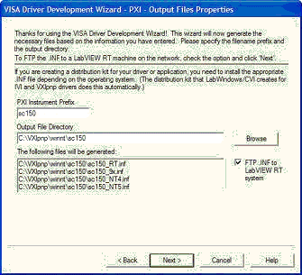

Output Files
The last dialog is the Output Files window illustrated in Figure 8. Here, you can specify the PXI instrument file name prefix that will be used for the device, and where the .INF files for each platform should be stored.
Figure 8 – Output Files Window
Note that LabVIEW Real-Time follows the 8.3 naming convention. Since the wizard appends the string “_RT” to the RT Target INF file name, the unique part of the file name is the first 5 characters.
In some cases, it is useful to have more than one .INF file for using the same device with different configurations. If this is the case, make sure that you provide a distinctive name for each file within the first 5 characters. Using the above example, if you want your files to be named “sc150a.INF” and “sc150b.INF”, you will run into problems because the wizard will truncate both names to “sc150_RT.INF”.
To install the .INF copy it (using anonymous FTP) it to the directory C:\ni-rt\system on the target PXI controller. If you have the LabVIEW Real-Time Module installed, the VISA Driver Development Wizard provides a check box (as shown in Figure 8) to FTP the file automatically. To copy the file to the intended controller using this feature, LabVIEW must be open and the RT system must be selected as the execution target.
The RT Target must be rebooted before the changes take effect.

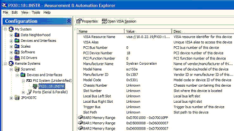

Viewing the Device in MAX
With the INF file installed, you can view the device using Measurement & Automation Explorer (MAX). Open MAX and press the <F5> function key to refresh the display.
Figure 9. SCRAMNet 150e card as a NI-VISA PXI Device in MAX
Note that the PXI device is now identified as VISA PXI resource. A PXI resource is uniquely identified in the system by three characteristics:
  • PCI bus number on which it is located
  • PCI device number it is assigned
  • Function number of the device
