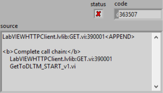

  • I am trying to perform a simple HTTP Get request to my company's internal webpage but I have encountered the following error. How should I resolve this error?
  • I am trying to perform a simple HTTP Get request to the Kaaiot Cloud Server with SSL/TLS enabled but I have encountered the following error. It works fine with other servers such as Google Maps and Bing Maps.
Error Code: 363507
Error Source:
LabVIEWHTTPClient.lvlib:GET.vi:390001<APPEND>
<b>Complete call chain:</b>
  GetToDLTM_START_v1.vi
This is error is caused when LabVIEW can not verify the authenticity of the server.

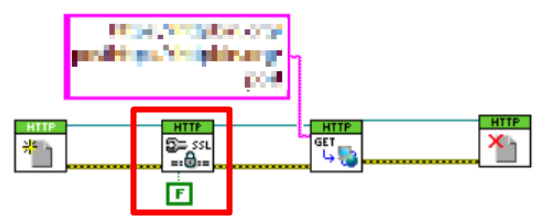

  • Not recommended for security reasons: If Secure Socket Layer (SSL) Certificate is not required in your application, the error can be resolved by disabling the default enabled SSL authentication using the ConfigSSL.VI as illustrated by the image below. If FALSE, this VI does not verify the server's identity and does not provide optimal security. Specifying FALSE allows the client to accept self-signed certificates signed by the certificate creator rather than a trusted CA.
You can check what certificates are used by your server using an online SSL checker.
