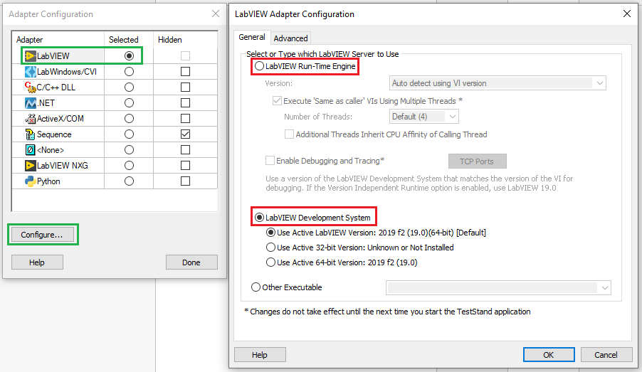

To get to the configuration dialog, select the TestStand menu options Configure ➔ Adapters...
Adapter Settings for TestStand

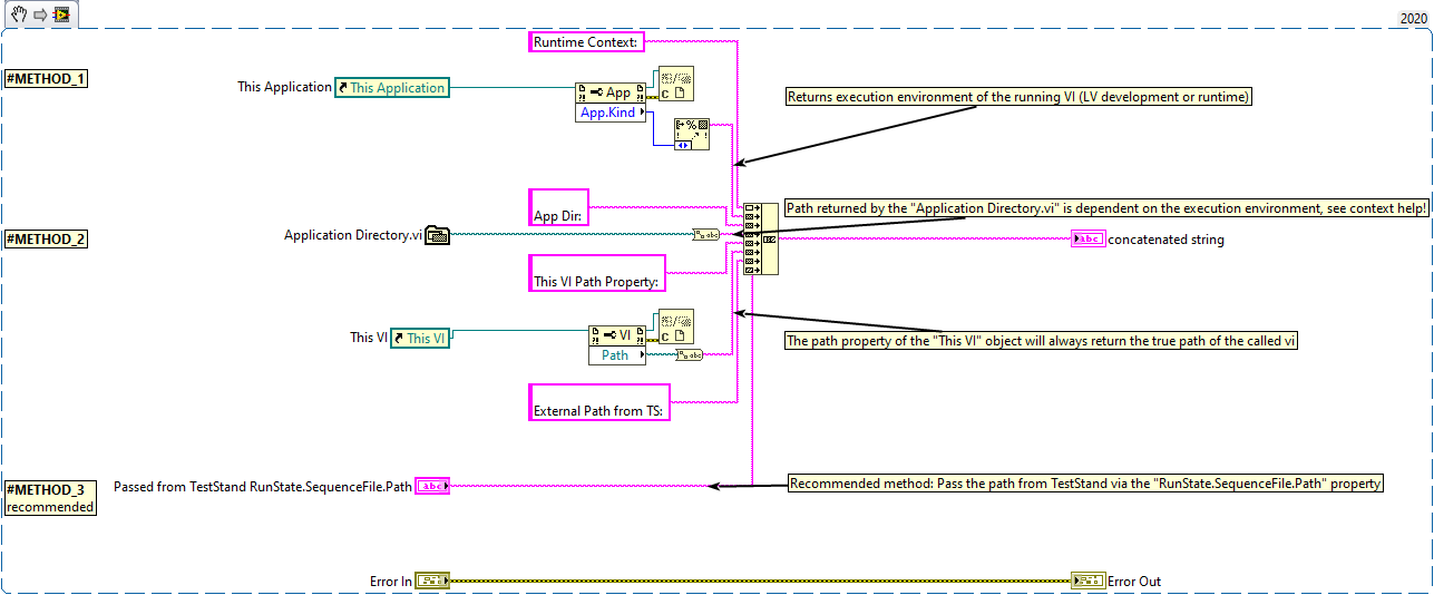

To amend the issue, please adapt your LabVIEW code to behave consistently. In the case of the Application Path, consider replacing the Application Path-VI with a String-Control that gets its path-string passed from TestStand. Alternatively, replace the Application Path-VI with the Path-Property of the calling This VI object.

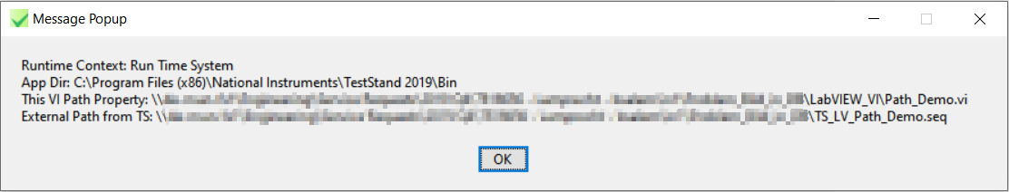

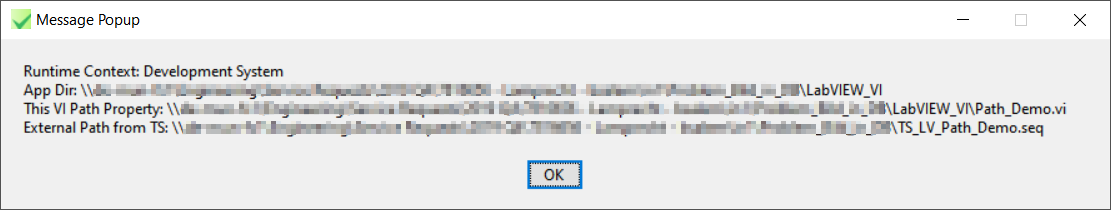

Observe the different paths returned when the VI is called using the LabVIEW Runtime or Development adapter. The example VI below and a TestStand sequence are included in the files section.
Please compare the results of the attached demo TestStand sequence TS_LV_Path_Demo_TS2019_32b.seq for further clarification.The Path_Demo.vi called by the TestStand sequence returns the currently used LabVIEW Adapter and paths generated by multiple methods:
  • using Application Path-VI
  • using the This VI >> Path property
  • a path string passed by TestStand

Executing the same LabVIEW VI from TestStand using the LabVIEW Develepments ystem (top) and the LabVIEW Runtime Engine (bottom).Note the different outputs of the "Application Path"-VI. The VI-Path-property remains unchanged. The external path was passed from the RunState.SequenceFile.Path TestStand property.​​​​
