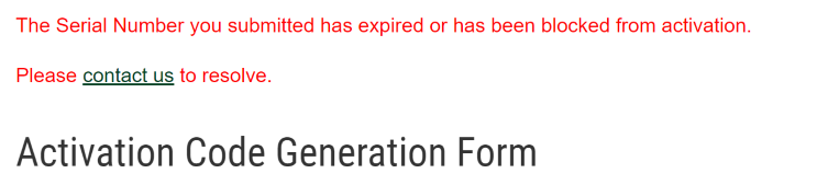

I receive the one of the following messages:
The Serial Number you submitted has expired or has been blocked from activation.
Please contact us to resolve.
Activation Code Generation Form.

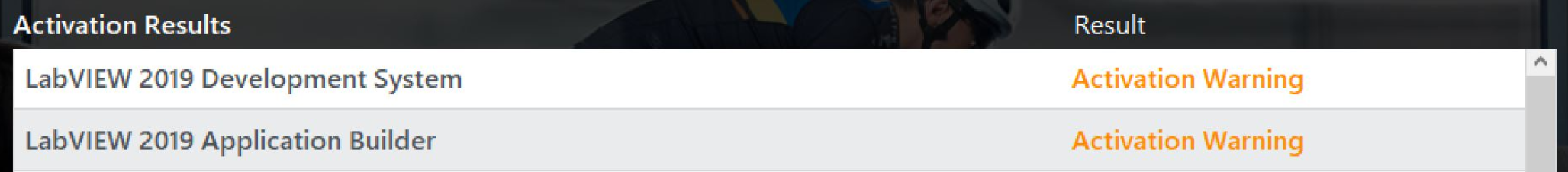

Activation Results                                                        Result
LabVIEW 2019 Development System                                           Activation Warning
LabVIEW 2019 Application Builder                                          Activation Warning
Invalid Serial Number
This is a known issue that, although it is common on Mac machines using the Bootcamp's Windows 10 Partition, can also happen in Windows 10 machines. See the relevant sections below for the solution steps.
Mac Bootcamp Partition
The problem is originated because the computer IDs of all the Bootcamps' Partitions are by default set to 6PZC-LFP4-SCXY-DFB6, and, as the licensing of the NI software is now identity-based with every machine, that specific computer ID has been blocked.
To fix this issue, contact NI Technical Support with the computer's MAC Address to create a new computer ID for the machine. Then, create new activation codes using the new Computer ID following the Getting 20 Digit Activation Codes for NI Software  guide.
