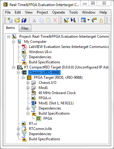

  3. Open the Intertarget Communication folder. Open Real-Time & FPGA Evaluation-Intertarget Communication.lvproj. This is where your entire system’s code and hardware resources are managed. A user interface that runs on your development computer has been created for you.
  4. In the LabVIEW Project, expand the Chassis project item. The CompactRIO is in LabVIEW FPGA Interface mode where modules are accessed through a LabVIEW FPGA program.

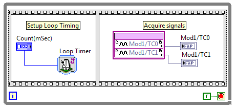

  1. Double-click to open the FPGA.vi. On the front panel you see only a few controls and indicators. These values are made available to the real-time application, which will be discussed later in this tutorial.
  1. Press <Ctrl-E> to open the block diagram. This is a simple FPGA application that sets loop timing in the first sequence and acquires two channels of temperature data in the second sequence.
