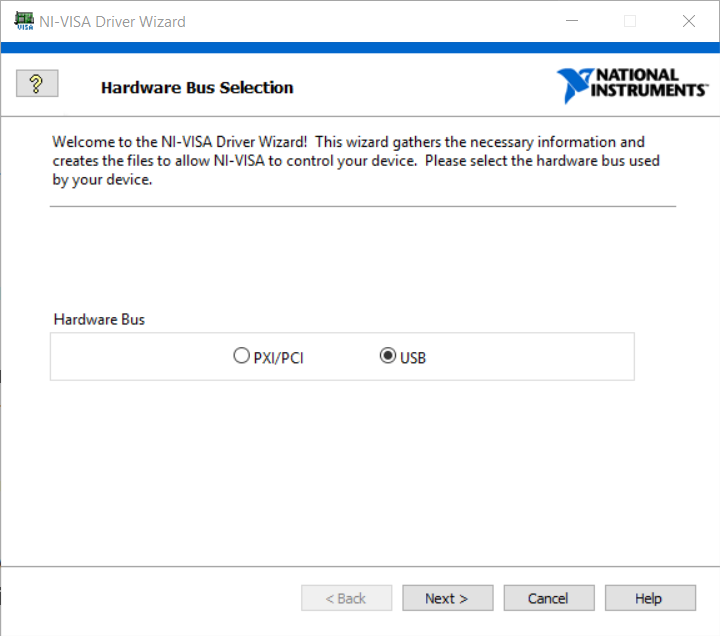

  1. Launch NI-VISA Driver Wizard from the Start menu.
  2. On the Hardware Bus Selection page, select USB. Click Next.

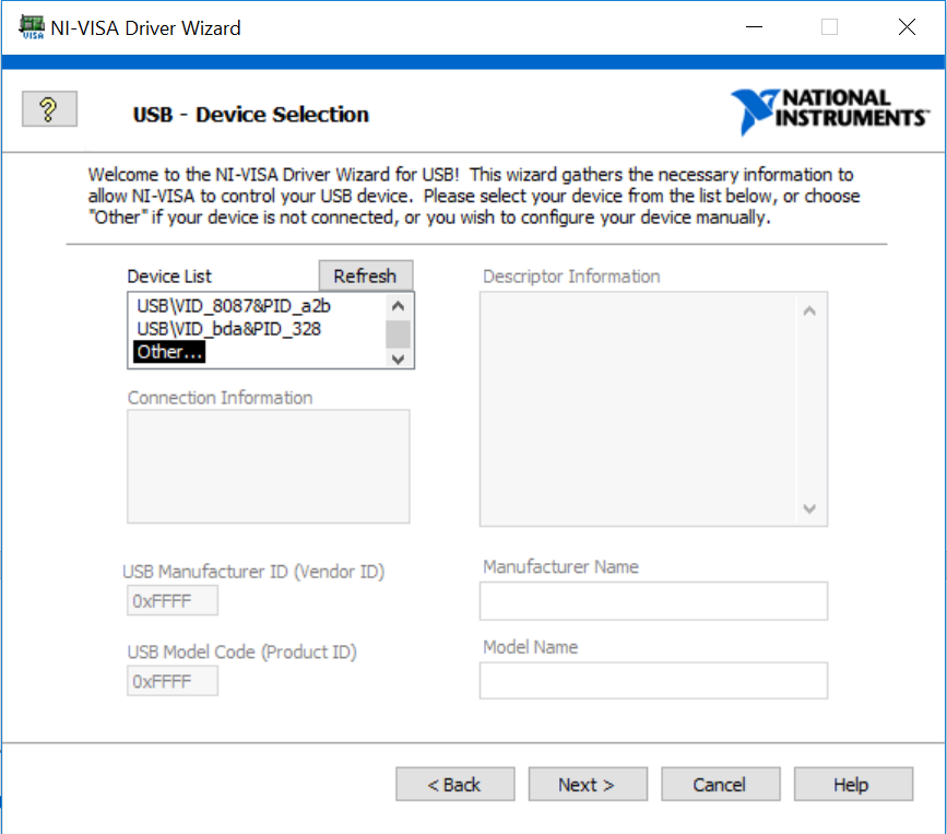

  1. On the Device Selection page, do one of the following:
    • If your device is already connected to the computer, select it from the device list and click Next. If you do not see your device on the list, make sure it is securely connected and select Refresh. Continue to Step 5.
    • If your device is not connected/unavailable, select Other… at the bottom of the list. Click Next.

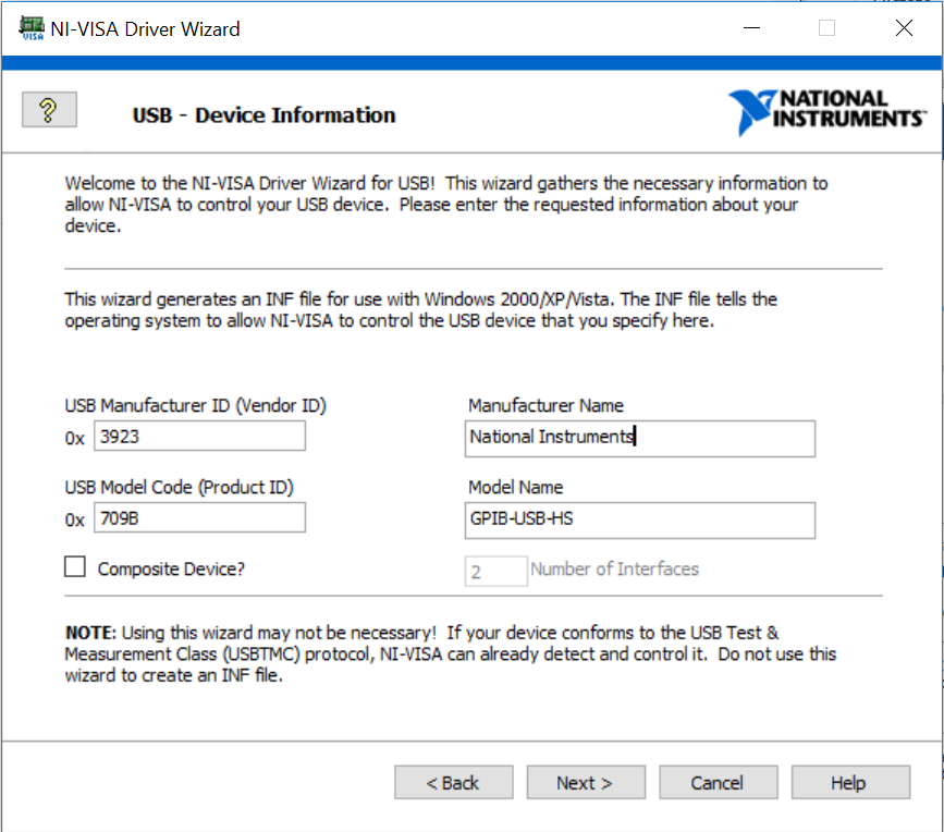

  1. If you selected Other…, manually input information about your device on the USB – Device Information page.
Click the question mark on the upper right of the window. This enables the Context Help and provides descriptions for each field.
To get the USB Manufacturer ID (Vendor ID) and USB Model Code (Product ID), refer to Find Vendor and Product ID for USB Device
Once you have the fields filled out, click Next. The image below shows an example for a National Instruments GPIB-USB-HS device.

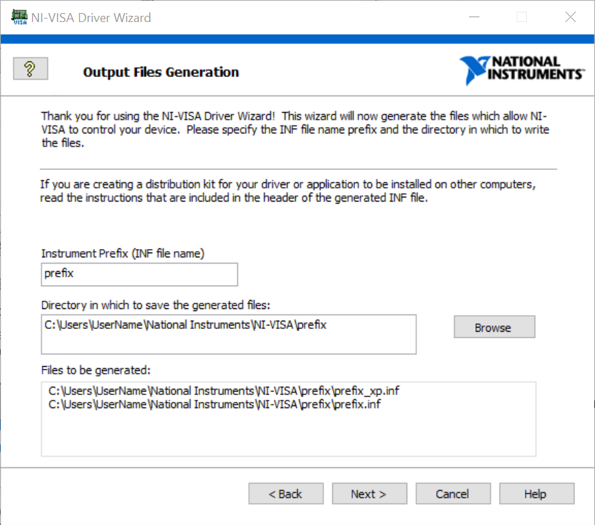

  1. On the Output Files Generation page, name your INF file in the Instrument Prefix field and specify where it should be saved. Click Next.
  2. On the Installation Options page, specify your installation option.
    • If you would like to have the  NI-VISA Driver Wizard automatically install the INF file for you, select Install the generated files on this computer and click Finish. This is the default and recommended option. Continue to the Install USB Instrument section.
Note: Choosing the Install the generated file(s) on this computer option requires administrator/root privilege.
  • If you would like to install the INF files yourself, select Do nothing and exit the wizard and click Finish. Continue to the section below.

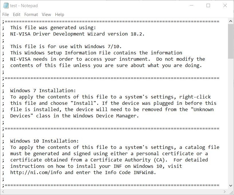

Install INF File
If you are manually installing the INF file, navigate to the location the INF file was created and open the INF file in any text editor (e.g., Notepad). The installation instructions are included in the header at the top of INF file.
For more detailed instructions, follow the steps below:
  1. If you’re using a Windows 8 machine or higher, you must sign the INF file first to install it on your computer. Windows 7 and earlier machines can skip to the next step.
  2. Make sure you are logged into an Administrator user account.
  3. Disconnect the USB instrument at this time so the driver will be properly associated with the device upon re-install.
  4. Copy the INF file to C:\\Windows\INF. If the INF folder is hidden, navigate to Tools >> Folder Options >> View >> Advanced Settings >> Show hidden files, folders, and drives to unhide it.
  5. Right-click on the INF file and click Install. This creates a PNF file for your device. You are now ready to install your USB instrument.

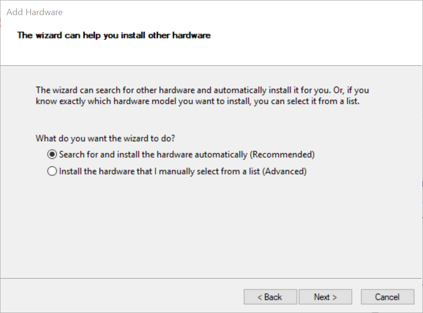

  1. Securely connect the USB instrument to the computer via a USB cable.
  2. Add New Hardware Wizard should automatically open after you connect your device. Select Next. On the Add Hardware page, select Search for and install the hardware automatically (Recommended).
  1. After an installation period, Windows should indicate that it has successfully installed your device.

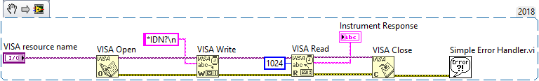

For USBTMC instruments, you can use the NI-VISA API to communicate with the instrument. An example snippet is provided below. This example opens a session to the USB instrument, performs a write of *IDN?\n, reads the specified number of bytes back from the instrument, closes the session, and handles any errors.
  1. Right-click on the snippet and save it as an image.
  2. Drag the image directly onto an empty LabVIEW block diagram.
  3. On the front panel, configure the VISA resource name to be the VISA resource of your instrument previously configured in this tutorial.
  4. Run the VI.
For more information on VISA functions, refer to LabVIEW Help: VISA VIs and Functions.
