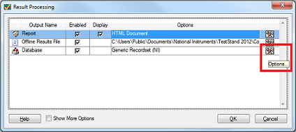

- Select Configure»Result Processing...
Select the Options button.
In the Data Link tab, select View Data.

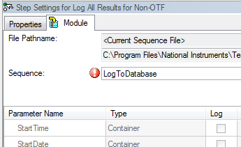

In the Model Plugin - UUT Done sequence file, select the Log All Results for Non-OTF subsequence step.
Reload the sequence by clicking on the red exclamation point.
Under the Name parameter, add Locals.Name to Value.

- Click on Configure»Result Processing»Options for Database to open the Database Options dialog box. Make sure database logging is enabled by selecting the Enabled option.

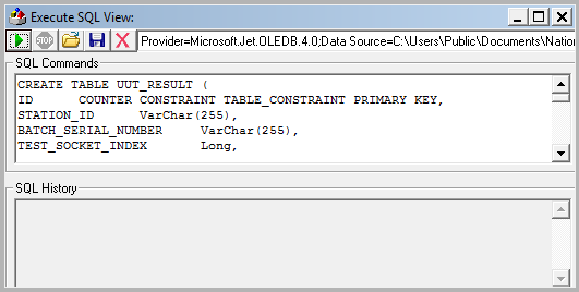

For the SQL Tools, with Add Missing Items selected, select Generate SQL.
	Note: A dialog box may pop up stating that there are more than one statement logging to the same table, select OK.
Run the SQL query in the Database Utility.
