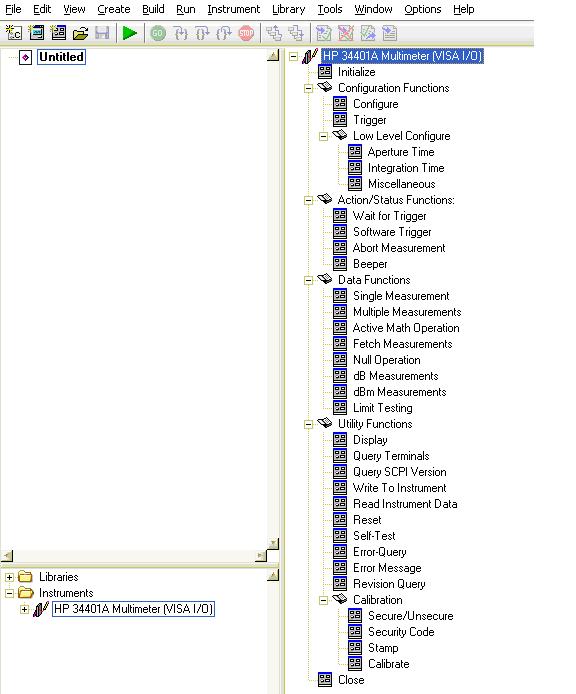

The following figure shows the function tree layout for the Agilent 34401A driver. You can double-click on any of the functions to open that function and edit or run it.
Figure 1. Agilent 34401 Function Tree Layout

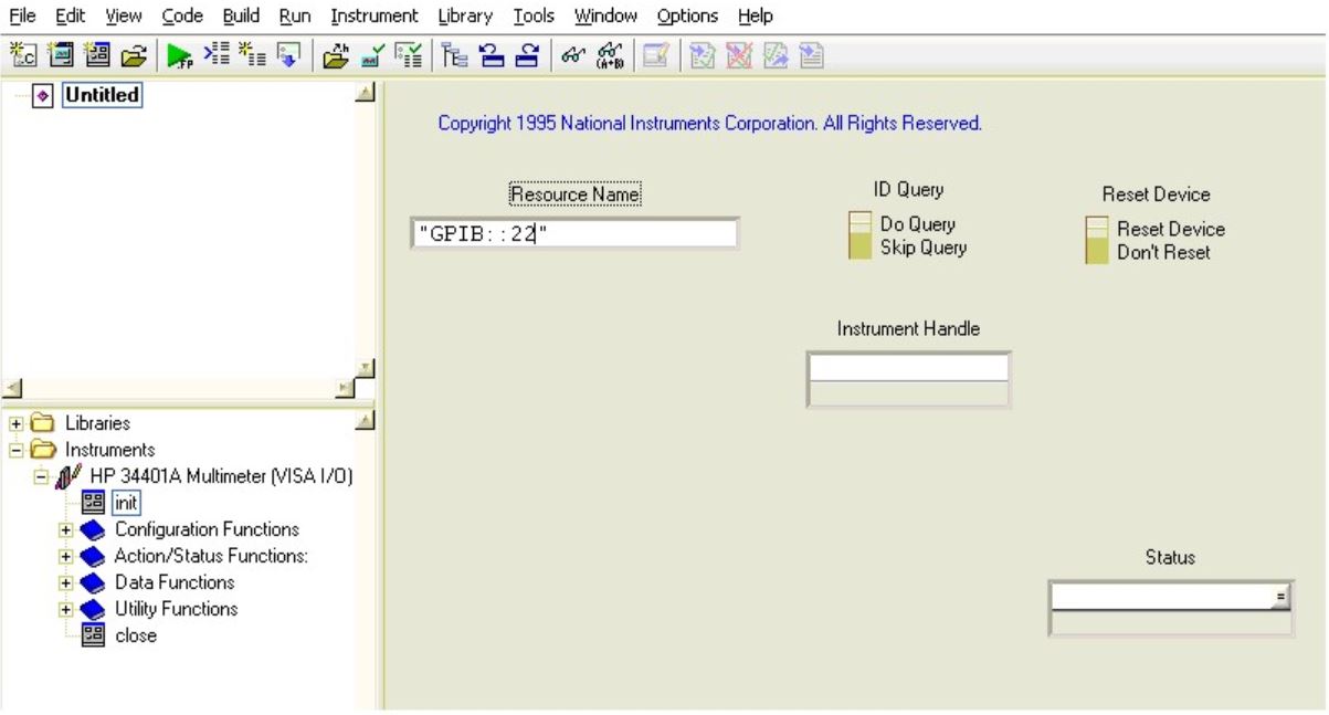

For example, if you double-click on the Initialize function, that function panel will open. This function performs the following initialization actions:
  • Opens a session to the Default Resource Manager resource and a session to the specified device using the interface and address specified in the Resource_Name control.
  • Performs an identification query on the instrument.
  • Resets the instrument to a known state.
  • Sends initialization commands to the instrument that set any necessary programmatic variables such as Headers Off, Short Command form, and Data Transfer Binary to the state necessary for the operation of the instrument driver.
  • Returns an Instrument Handle which is used to differentiate between different sessions of this instrument driver.
  • Each time this function is invoked a Unique Session is opened. It is possible to have more than one session open for the same resource.
Figure 2. Agilent 34401 Initialize Function

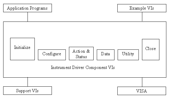

Instrument Driver Organization
The following figure shows the organization of a typical instrument driver.
Figure 3. Instrument Driver Organization
A LabWindows/CVI instrument driver typically consists of the following three or four files. Each file has the same base file name, which is typically an abbreviation of the actual instrument name. The instrument driver files must reside in the same directory on your disk, or they must be in the appropriate VXIplug&play directories or in the appropriate IVI directories.
  • The function panels are in a .fp file.
  • For instrument drivers that use an attribute model, such as IVI drivers, there can be an additional .sub file that contains attribute information displayed in the function panels.
  • The function, variable, and defined constant declarations are in a .h include file.
  • The instrument driver program can be in one of several different types of files.
    • .c source file
    • .obj object file that contains one or more compiled C modules
    • .lib library file
You must compile these files in LabWindows/CVI or in a compatible external compiler.
For example, the instrument module files for the Agilent (HP) 34401A multimeter are hp34401a.fp, hp34401a.c, and hp34401a.h. A Word document that describes the functionality of that particular instrument driver is also included when you download an instrument driver. This document is intended to be used as a programming reference manual.
You can load an instrument driver into the LabWindows/CVI interactive program whether the instrument program is in the form of a .c, .obj, or .lib file. The presence of the .h file is essential because you must include it in your program to refer to functions, global variables, and constants in the instrument driver.
