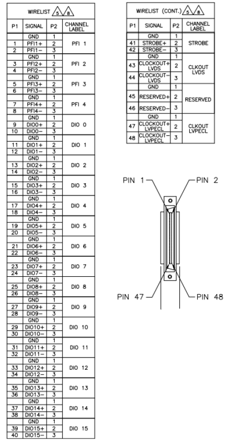

I am looking to the pinout for the Infiniband Connector of the NI SHB12X-H3X24. Where can I find it?
The pinout for this connector is the following:
You can find more detailed information about this cable in the Differential Digital Flying Lead Cable User Guide .
