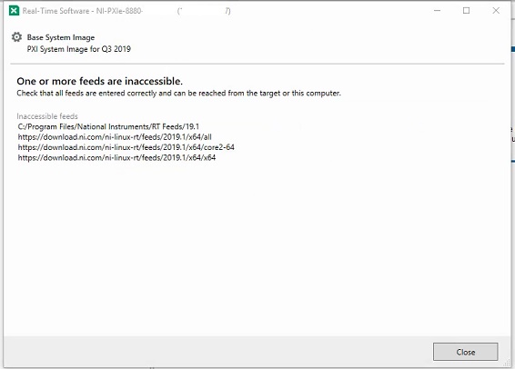

  • When I try to install software on my NI Linux Real-Time (RT) controller through NI MAX or the NI Hardware Configuration Utility, I receive the message below.  This happens either with the online or offline installation.
One or more feeds are inaccessible. Check that all feeds are entered correctly and can be reached from the target on this computer.
  • When I try to install software on my NI Linux Real-Time (RT) controller through NI MAX or the NI Hardware Configuration Utility, I receive the following error when I attempt to do an online installation:
Check that all feeds are entered correctly and can be reached form the target or this computer.
Exception details
Running 'opkg update' failed to access at least one enabled feed. Consider disabling unnecessary feeds.
Second type of error related to the One or more feeds are inaccessible message, this one related to 'opkg update' command failing

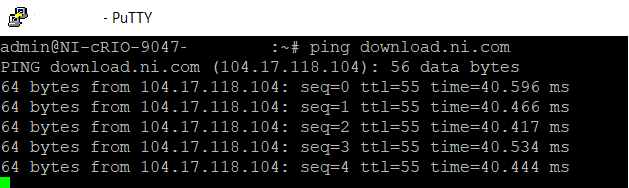

If the Real-Time(RT) target has internet access, make sure it can connect to download.ni.com. To check this:
  1. Set up an SSH connection to the RT target from the host PC
  2. Use the following command to ping the NI feed site:  ping download.ni.com.
  3. If the connection is successful, you should get replies as shown below. If not, continue with other troubleshooting below or try the offline installation method below.
  1. Most likely, you won't have any issues using this method, but if you have, check the General Troubleshooting section below.

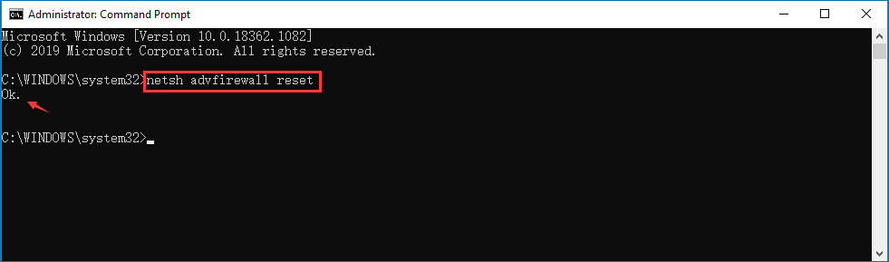

  • Make sure that the NI RT Feed Host Configuration software is allowed to make changes to your computer. If you are not sure if it has the correct permissions, please follow the steps below:
  1. Open Command Prompt as administrator on your PC.
  2. Run the netsh advfirewall reset command, as shown in the image below. This will reset your firewall to its default configuration.
  1. Go to NI MAX and retry adding software to your RT controller. A window asking for your permission to allow the NI RT Feed Host Configuration software to make changes to your PC may pop up. Click on the Yes button to allow access. Review the following picture for more information.
