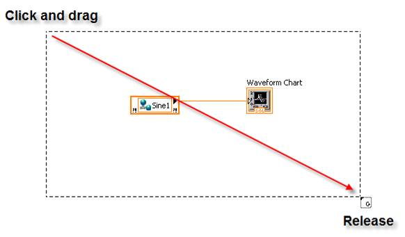

  1. Using the while loop cursor, place a while loop around the shared variable and waveform chart by clicking and dragging the cursor.  Now create a Stop control in while loop by right-clicking on the Loop Condition and selecting Create Control.  This places a Stop button on your Front Panel which allows the user to stop the VI.
Figure 13. Placing a While Loop around the Shared Variable and Waveform Chart
The while loop causes the code within it to execute continuously until stopped by the user or additional logic in the VI.
