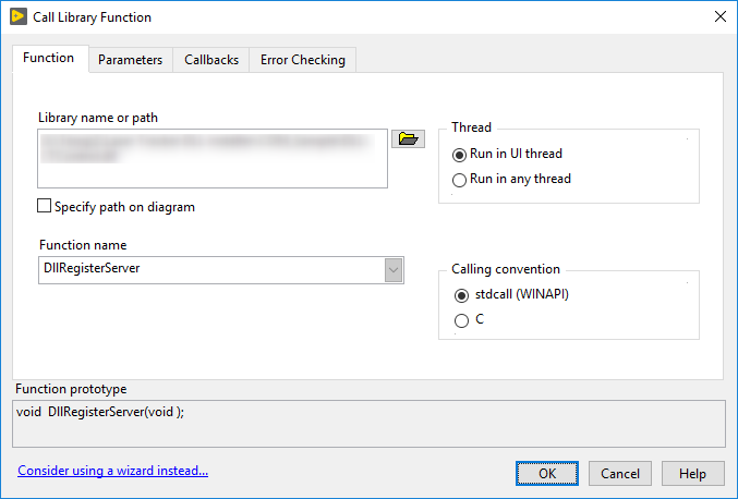

  1. Search for the Call Library Function Node located in the functions palette under Connectivity>>Libraries and Executables, as seen below:
  1. Place this function on your block diagram and double click on it. The below menu will appear:
  1. Select the small file icon next to the Library name or path box, then browse to and select the DLL you wish to register.
  2. In the Function name drop down list select the DllRegisterServer function and press OK.
  3. Save and run the VI containing this function. This will register the DLL for use and all users will be able to call it.
