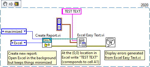

I am developing a LabVIEW VI using the Report Generation Toolkit for Microsoft Office. I am creating an Excel document using the New Report.vi and writing values to that report using the Excel Easy Text.vi.
When I run my program, my report is not written to and my error handler reports Error -2146827284 occurred at an unidentified location. What causes this error to occur and how do I prevent it from happening?
This error is being thrown by a specific invoke method within Excel Easy Text.vi. The following fixes will prevent this error from being thrown.
  1. Change the minimized enum constant connected to the Create Report.vi to maximizedno change, or normal (One example can be seen in the snippet below.)
  2. Make sure you have the Microsoft Excel program fully opened before running your program.
Solution Snippet ("minimized" enum changed to "maximized")
