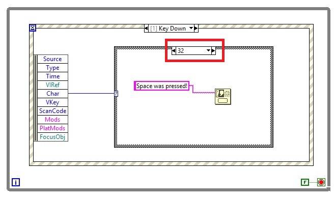

  1. To bind the event for a specific key, navigate to the Key Down event on the Block Diagram by clicking on the black arrows at the top border of the structure.
  2. Create a Case Structure.
  3. Wire the Char output to the case selector terminal of the Case Structure.
  4. Configure the Case Structure with the decimal [External] ASCII codes of the key as on the following screenshot:
