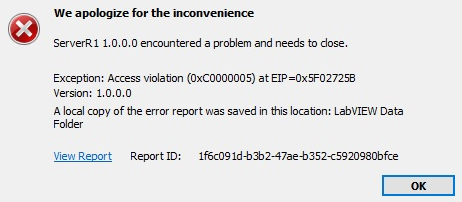

  • When trying to run my LabVIEW executable, it crashes and gives an access violation 0xC0000005 error.
  • When I run my application in the development environment it works correctly, but if I create an executable for my application  and run it I receive the following error:
    Exception: Access violation (0xC0000005) at EIP=0x5F02725B
  • I've created an application that recalls the GetWindowTextA function in the Windows user32.dll. Sometimes when running my program in the development environment, and always when running an executable of the program, I receive the following error:
    Exception: Access violation (0xC0000005) at EIP=0x64D332C7
How can I fix this behavior?

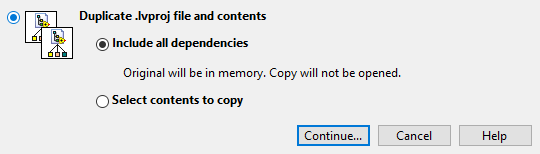

To resolve the Exception: Access violation (0xC0000005) at EIP=0x5F02725B issue, try the following troubleshooting steps:
  1. Create a new LabVIEW project
  2. Drag and drop all the VIs and files used in the project that you used for building the executable
  3. Save the project
  4. Repeat the saving process, but this time select Save As and duplicate the project with all dependencies, as shown in the figure below.
  1. Close the project and then open the last saved
  2. Create the executable

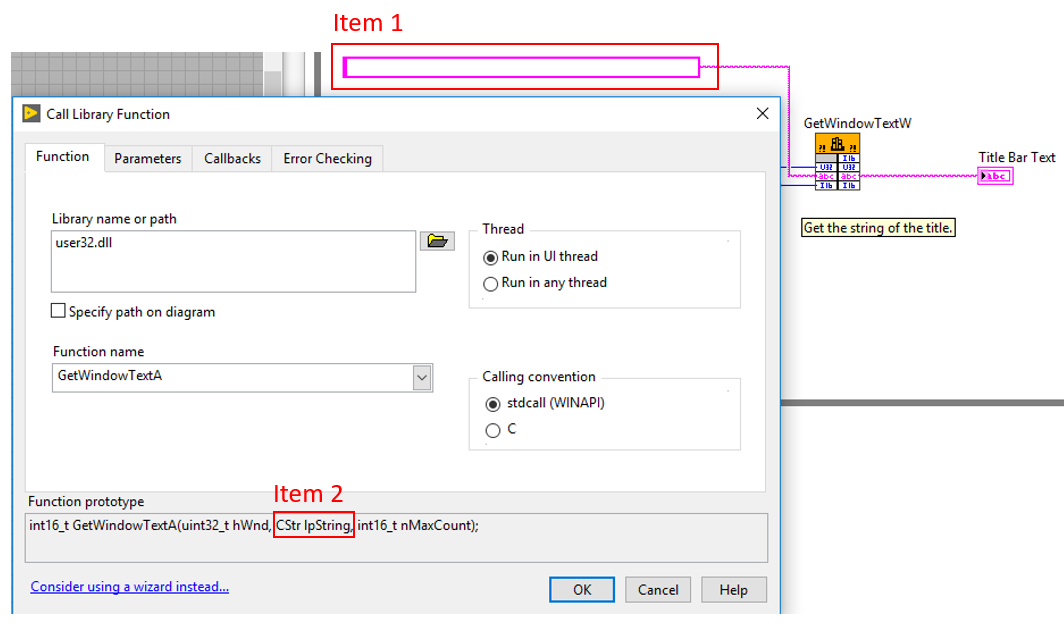

To resolve the Exception: Access violation (0xC0000005) at EIP=0x64D332C7 issue, try the following troubleshooting steps:
  1. Open the .vi where you are calling the GetWindowTextA function in the Windows user32.dll
  2. Increase the dimension, in terms of space, of the constant (item 1 in the figure below) connected to the CStr IpString terminal (item 2 in the figure below). This constant is used to determine the available space in the buffer. You can add empty Spacebar characters in the string constant to increase its space.
