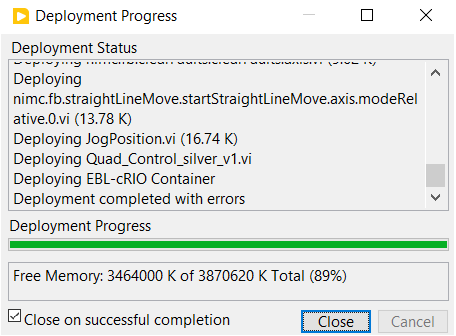

I am observing the following message when trying to deploy my LabVIEW project into a  Real-Time target:
"Deployment completed with errors"
As illustrated below, no additional information about the cause of the issue is displayed.

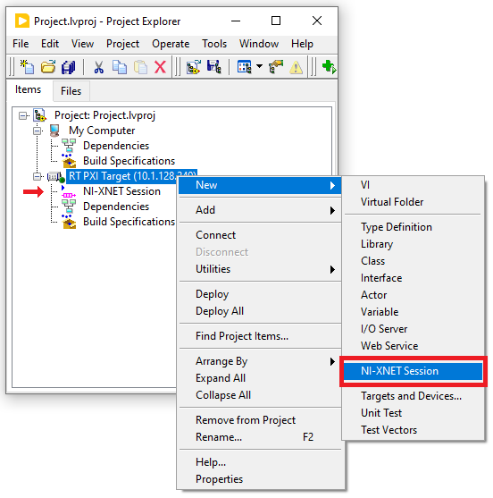

  • My LabVIEW project includes NI-XNET Sessions, as shown in the image below.
The "Deployment completed with error" message is usually related to a driver or module that failed to be correctly deployed due to invalid settings or configuration of the Real-Time target. In other less common circumstances, it can be caused by corruption in the software. Possible solutions to the issue are shown below:
  • Restart your PC.
  • Verify that your licenses of the LabVIEW Real Time module and additional modules are not expired or inactive. To verify this, refer to the following site: What NI Software Licenses Are on My Machine?
  • You can verify if, during the modifications, some controls, subVIs, or functions got corrupted by running a Mass Compile on your project and checking for a VI listed as Bad VI, so you can open it and check for errors. For further information about the Mass Compile process, please refer to the resource: How to Mass Compile in LabVIEW.
  • If you use NI-XNET Sessions or functions in your LabVIEW project, verify first that the database can be deployed to the target. LabVIEW can't deploy NI-XNET databases to a password-protected target. To work around this, you can:
    • Temporarily remove the password from the target before deploying the project.
    • Use the Alias Manager in the NI-XNET Database Editor to manually deploy the database to the target first. For detailed instructions, refer to the resource: How to Deploy XNET Database into Real-Time Targets.
    • Programmatically deploy the database by calling the XNET Database Deploy VI, and including the username and password in the IP address string, as shown in the image below.
