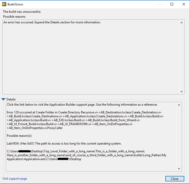

I built a LabVIEW project which calls SubVIs. The whole project and/or the SubVIs are located in folders that have a long file path e.g. on Network drives. When I use the LabVIEW Application Builder to build an executable, the build fails. The Application Builder throws the following error:
Error 129 occurred at <function inside the SubVIs>
Possible reason(s):
LabVIEW: (Hex 0x81) The path to access is too long for the current operating system.
This error occurs if the called SubVI's path is too long and exceeds a value of 255. To resolve this issue, try one of the steps below:

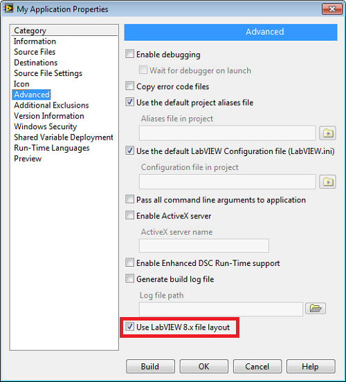

  • For an application or shared library builds, check the Use LabVIEW 8.x file layout checkbox on the Advanced tab of the build specification Properties dialog box
rtaImage.jfif
