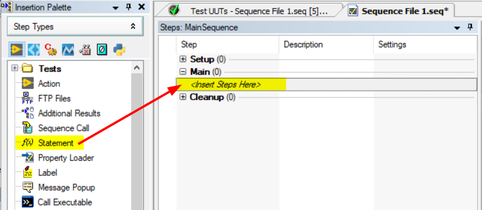

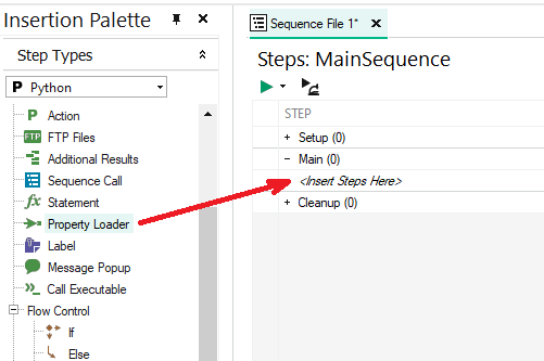

  1. Add a new Statement step to your sequence.
inserting statement step to the sequence

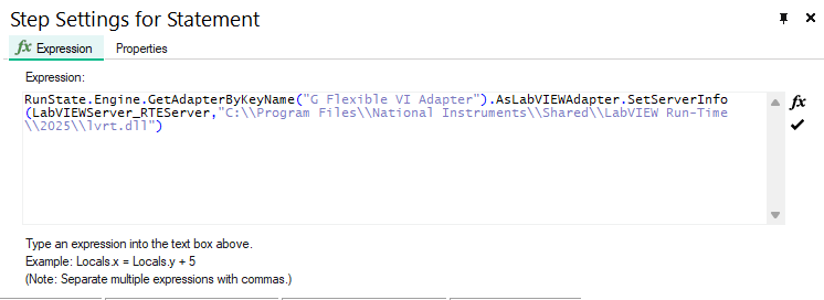

  1. In the Expression field, enter the following statement based on the bitness of the TestStand sequence file.
64-bit TestStand sequence file:
RunState.Engine.GetAdapterByKeyName("G Flexible VI Adapter").AsLabVIEWAdapter.SetServerInfo(LabVIEWServer_RTEServer,"C:\\Program Files\\National Instruments\\Shared\\LabVIEW Run-Time\\<xxxx>\\lvrt.dll")
Where xxxx is the version of LabVIEW Run-Time.
statement
32-bit TestStand sequence file:
RunState.Engine.GetAdapterByKeyName("G Flexible VI Adapter").AsLabVIEWAdapter.SetServerInfo(LabVIEWServer_RTEServer,"C:\\Program Files (x86)\\National Instruments\\Shared\\LabVIEW Run-Time\\<xxxx>>\\lvrt.dll")
Where xxxx is the version of LabVIEW Run-Time. An example is shown below

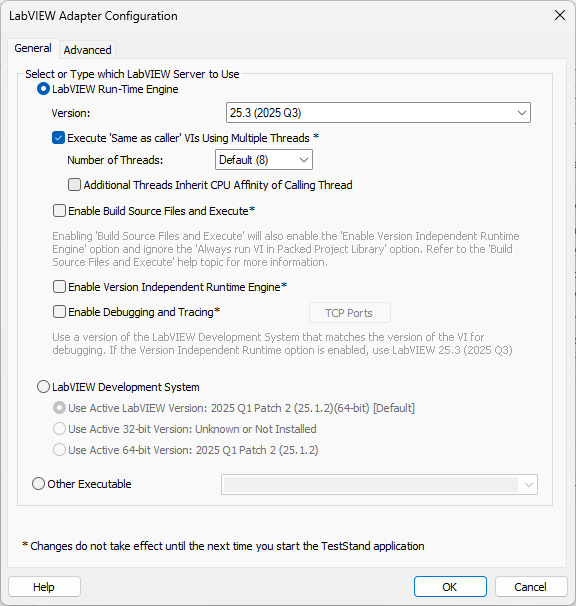

  1. Execute the sequence. The LabVIEW adapter should switch to LabVIEW Run-Time Engine.
LabVIEW Adapter Configuration Dialog showing the LabVIEW RTE Adapter selected
