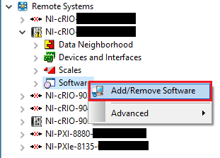

  1. Right click and select Add/Remove Software on the device which you want install.

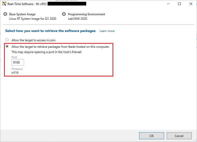

  1. Select the option of Allow the target to retrieve packages from the feeds hosted on this computer and then click OK. The host computer will start NI Web Server for hosting the feeds.

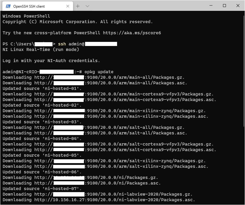

  1. Using ssh to login and type opkg update to update the package lists. You could see that it will update with local feeds (http://[host IP Address]:9100/20.0.0/...).

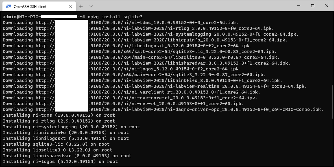

  1. Using opkg install to install the packages and you will see that it will download the ipk from local feeds. DO NOT close the window below during the OPKG installation.
