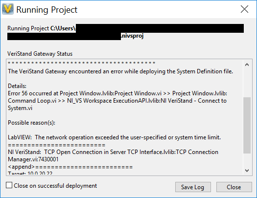

我正尝试部署VeriStand项目,但获得错误消息。
The VeriStand Gateway encountered an error while deploying the System Definition file.
Details:
Error 56 occurred at Project Window.lvlib:Project Window.vi >> Project Window.lvlib:Command Loop.vi >> NI_VS Workspace ExecutionAPI.lvlib:NI VeriStand - Connect to System.vi
Possible reason(s):
LabVIEW:  The network operation exceeded the user-specified or system time limit.

错误56是由代码在用户定义的时限内未收到网络响应引起的。此错误是一般的超时错误,有可能是许多不同因素导致的。
