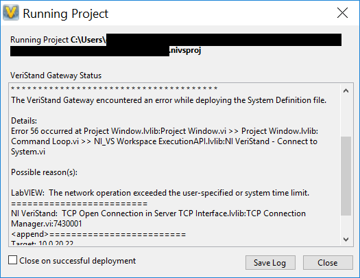

This timeout error can be caused by configuring the TCP/IP functions incorrectly, and can often be cleared without detriment, as long as the data is being received. If the data is not being received, there are several troubleshooting steps below to mitigate this error.
- Try deploying a blank System Definition by only specifying the controller settings.
- Ensure you have the appropriate drivers for VeriStand listed in the VeriStand Readme
- Ensure that the correct IP Address and Controller OS are specified in the System Definition.
- Ensure that the network cable is properly connected to each system or that the wireless network connection is properly established.
- Try a direct Ethernet connection between the host PC and RT Targets if possible
- Try to reach the network devices in question with a ping command in order to verify that the devices are still connected and communicating.
	- The response time should be minimized to ensure that VeriStand has enough time to deploy necessary dependencies like Custom Devices.
- Turn off all firewalls and antivirus software packages installed on the host computer to ensure no ports are blocked.
- Make sure that both devices are on the same subnet, and have the same subnet mask. See "Inconsistent IP Settings" When Connecting to Real-Time Target in NI MAX for more information on configuring NI network devices.
- Check if excessive local network traffic has slowed your network communication and caused transfers to take longer than expected.
