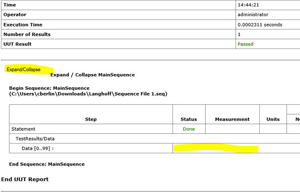

I set my result processing to save the report on a network drive and set it to draw arrays as graphs. Although my report is correctly created, the graphs are not displayed.
The issue is due to the browser/report control not allowing the graph controls to get rendered when the report file is saved in a network location. The following workarounds are available:

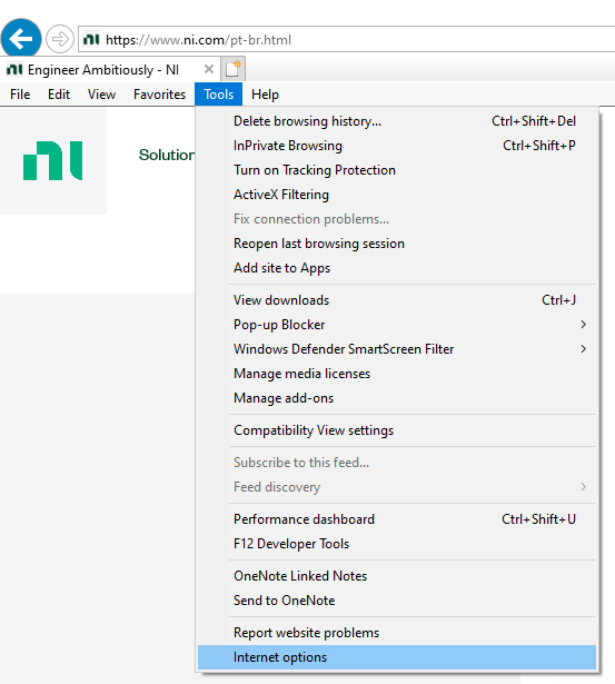

  3. On the menu bar, go to Tools>>Internet Options.
    Opening Internet Options

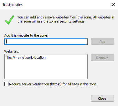

  5. Click on the Sites button. the Trusted Sites dialog should appear. If you cannot edit the trusted sites list (controls and indicators are grayed out), IT rules probably block this feature, so contact your IT administrator.
    Trusted Sites Dialog
  6. Uncheck the Require server verification (https:) for all sites in this zone, then add your network location.
  7. Click Close, then Apply and OK on the Internet Options dialog.
