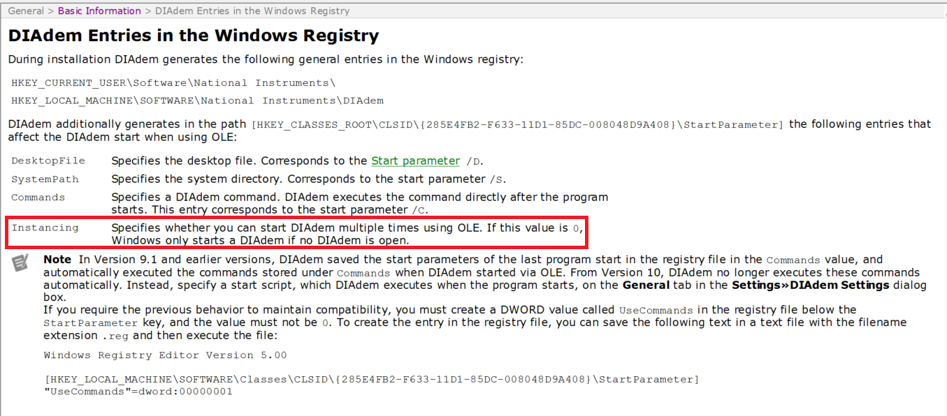

To open multiple instances you need to modify a DIAdem registry entry called Instancing described in DIAdem Entries in the Windows Registry.
DIAdem_Instancing_Information

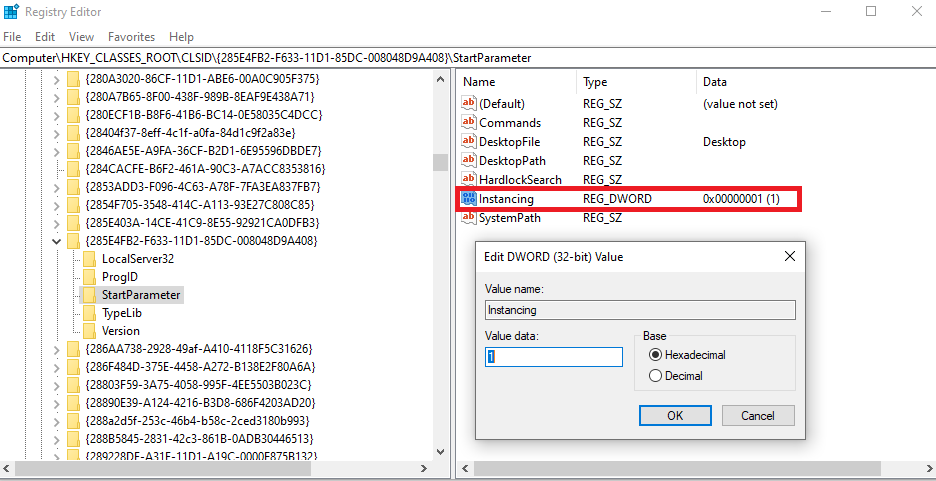

  1. Open Registry Editor application on your Windows PC and navigate to HKEY_CLASSES_ROOT\CLSID\{285E4FB2-F633-11D1-85DC-008048D9A408}\StartParameter
  2. Change the value data of Instancing (REG_DWORD) option to 1 which allows you to open and control multiple instances of DIAdem.
Instancing_option_change
