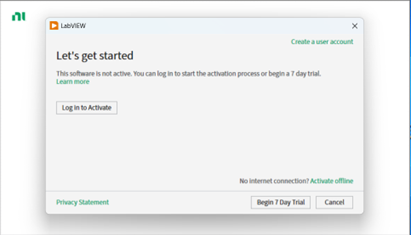

- Open the software. You will see a prompt asking you to activate the product, click on Log in to Activate.

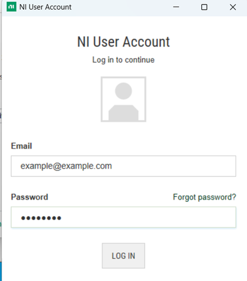

- Input your account info to the Activation Wizard using the same account that you used to download the software.

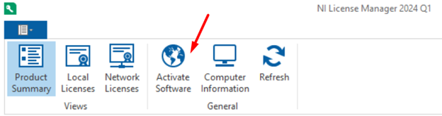

NI License Manager Sign-On

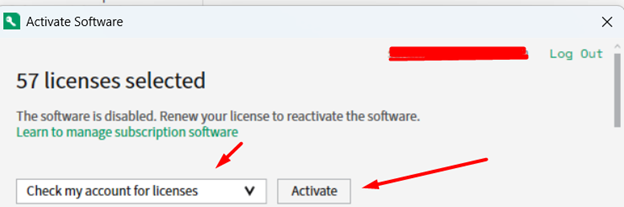

- Open NI License Manager and select the Activate Software tab.
- Login to the Activation Wizard using the same account that you used to download the software.
- Select Check my account for licenses and then click on Activate.

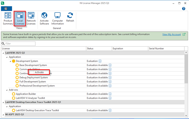

If activation fails or you receive errors:
- Go to the Local Licenses tab in License Manager.
- Expand the software list to display the Community Edition for the LabVIEW version installed.
- Right-click and select Activate.
