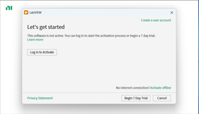

  1. Open the software. You will see a prompt asking you to activate the product, click on Log in to Activate
                                                    Log in to activate

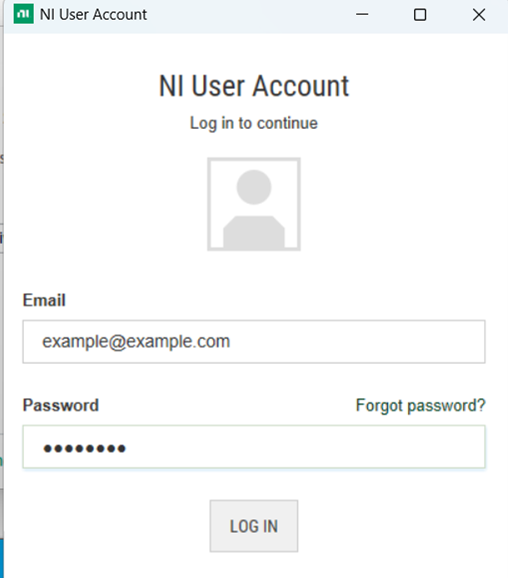

  1. Input your account info to the Activation Wizard using the same account that you used to download the software.
                                                                          User log information

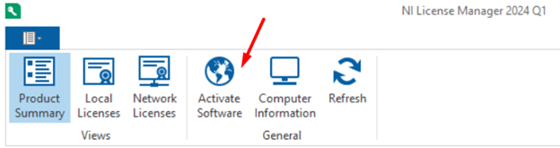

  1. Open NI License Manager and select the Activate Software tab.
                                                   Activate software

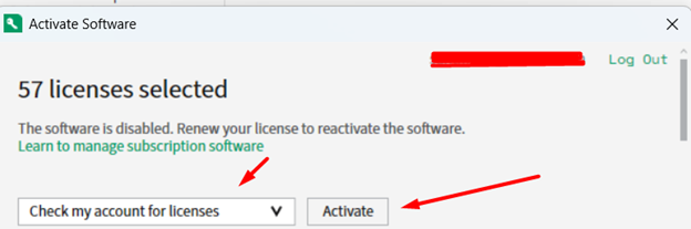

  1. Login to the Activation Wizard using the same account that you used to download the software.
  2. Select Check my account for licenses and then click on Activate.
                                              Check account

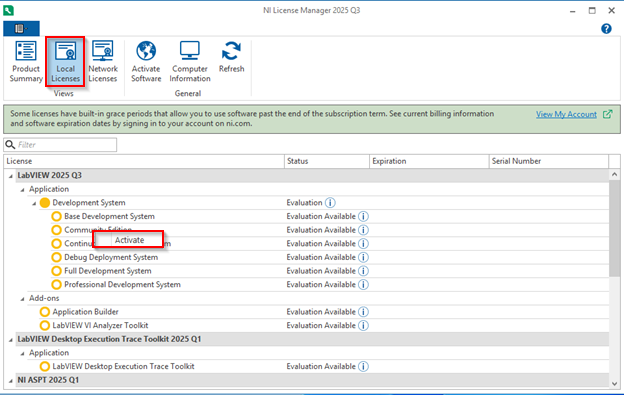

If activation fails or you receive errors:
  1. Go to the Local Licenses tab in License Manager.
  2. Expand the software list to display the Community Edition for the LabVIEW version installed.
  3. Right-click and select Activate.
