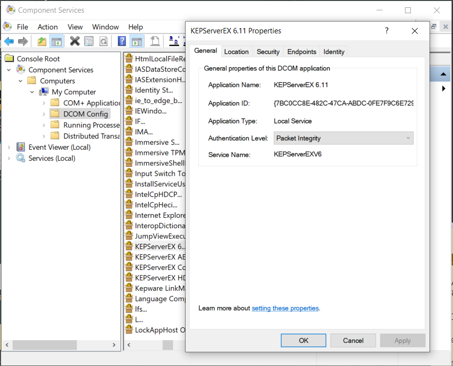

I am using the LabVIEW OPC UA Toolkit to create a Client VI that will communicate with an OPC DA server.
I would like to know if the recently announced hardening changes of Microsoft DCOM Communication will have an effect on an OPC DA/UA connections.
OPC-DA Clients and Servers must utilize the same DCOM authentication level. Once the Kepware software DCOM authentication level is changed, the DCOM authentication level used by third-party clients and servers on remote workstations must also be updated.
The Microsoft Windows cumulative updates will have no impact on OPC UA Connection and the changes will only impact OPC DA.
Please follow below steps to disable the new security.
  • Kepware products can be set to use the newly required (by Microsoft) DCOM security with the Windows DCOM configuration utility (DCOMCNFG.EXE). No patch is required
  1. The DCOM Authentication Level will need to be set to Packet Level Integrity for both the Client and the Server.
  2. For Server applications this change will need to be made at the Application level:
      3. For Client applications this change will need to be made at the My Computer level:
  • Note: KEPServerEX may be the Client, Server or both
  • In addition to DCOM configuration, the following product settings must be enabled:
               1. KEPServerEX; ThingWorx Kepware Server; OPC Aggregator: Settings>Runtime Options> Use DCOM configuration settings
2. OPC Quick Client:Tools>Options>Use DCOM for remote security
3. LinkMaster: Tools>Options>Runtime Options>Use DCOM configuration utility settings Other resolution options:
