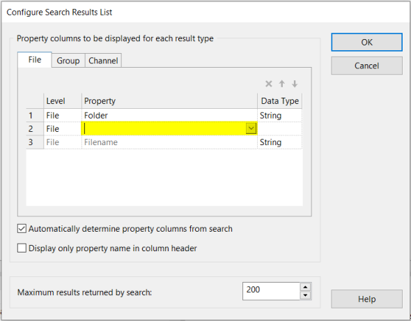

To display the filepath in the Search Results, you may need
to configure this. Note it is displayed as the Folder and the Filename separately.
- Right click anywhere in the Search Results pane.
- Select Configure Results List... from the menu.
- Add the property Folder to the File tab.
- Use the up and down arrow icons to change the order of the columns and select OK when done.
The above will give you the expected number of entries in your results.
