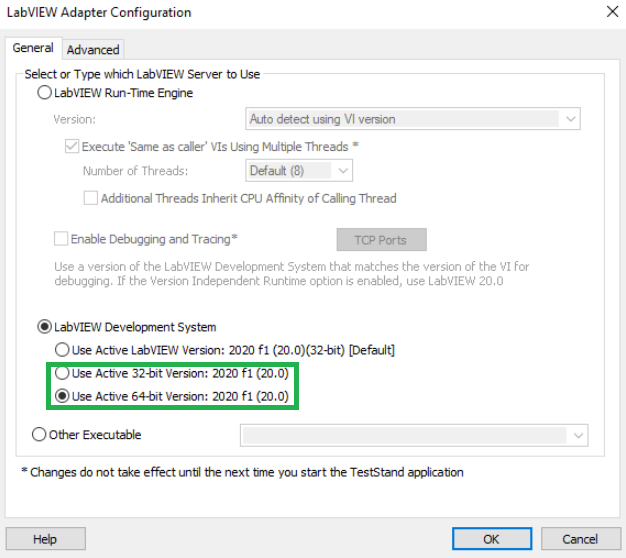

Using TestStand, the LabVIEW adapter settings allow you to define how LabVIEW code is called by TestStand.
The recommended setting for deployed test systems is using the LabVIEW Run-Time Engine. This however forces LabVIEW code to have the same bitness as TestStand because the LabVIEW Run-Time Engine is attached to the process of the TestStand User Interface.
Changing the TestStand LabVIEW adapter setting to use the LabVIEW Development Environment will spawn a new OS process for LabVIEW. You can select the bitness of that process and it can be different from TestStand:
The TestStand sequence execution will control the LabVIEW process to load and run LabVIEW code as needed by the test execution.
Using this configuration allows you to call LabVIEW code which is of different bitness than TestStand.

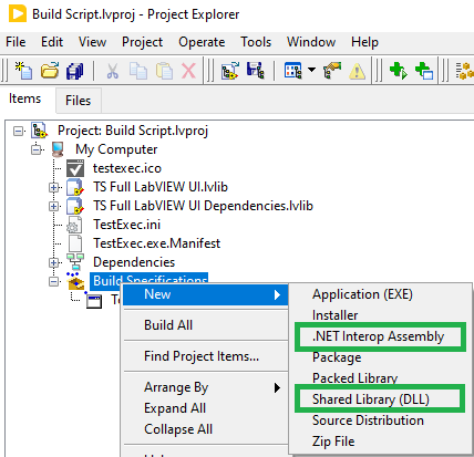

You can compile LabVIEW code as C/C++ DLL or .NET interop assembly using the LabVIEW Application Builder.
Use the C/C++ adapter or .NET adapter in TestStand accordingly to call that built LabVIEW code.

Using TestStand 32-bit, you have to do the following:
  1. Configure the LabVIEW adapter in TestStand to LabVIEW Development Environment 64-bit. This requires the computer to have an activated developer license of LabVIEW 64-bit. Use the LabVIEW adapter for all steps which call LabVIEW code in 64-bit.
  2. Do one or any combination of the following as deemed suitable. Both require installation of the 32-bit LabVIEW Run-Time Engine.
    1. Recompile LabVIEW code which is 32-bit into a DLL (C/C++ or .NET) using LabVIEW Development Environment with Application Builder. This requires a computer to have an activated developer license of LabVIEW 32-bit.
      The computer can be a different one as the computer you are using for TestStand. In that case you have to deploy the DLL file including all dependencies (e.g. configuration files) to the test computer. Use the C/C++ adapter for all steps which call the C/C++ DLL you created with LabVIEW and the .NET adapter for all steps which call the .NET assembly you created with LabVIEW.

Using TestStand 64-bit, you have to do the following:
  1. Configure the LabVIEW adapter in TestStand to LabVIEW Development Environment 32-bit. This requires the computer to have an activated developer license of LabVIEW 32-bit. Use the LabVIEW adapter for all steps which call LabVIEW code in 32-bit.
  2. Do one or any combination of the following as deemed suitable. Both require installation of the 64-bit LabVIEW Run-Time Engine.
    1. Recompile LabVIEW code which is 64-bit into a DLL (C/C++ or .NET) using LabVIEW Development Environment with Application Builder. This requires a computer to have an activated developer license of LabVIEW 64-bit.
