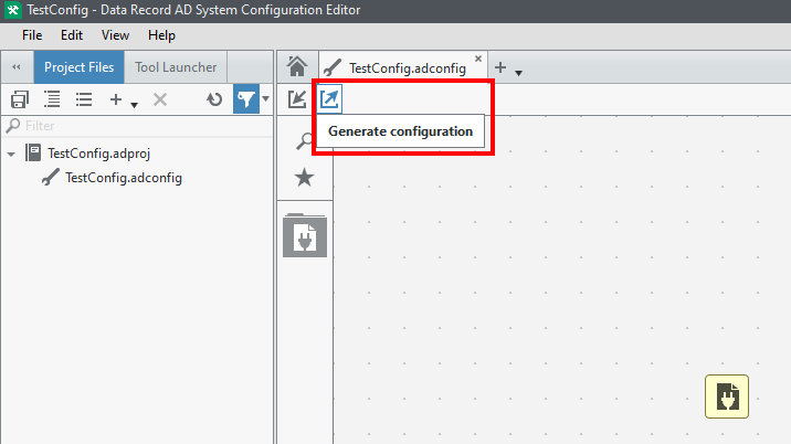

  • Make sure you are pointing to a Data Record AD .json configuration file and not the Data Record AD System Configuration Editor's project file with extension .adconfig.

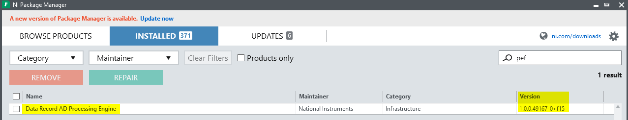

  • Check the PEF Engine is installed and a compatible version with your Data Record AD application
    • Attempt a repair on this software package.

The Data Record AD Application and underlying PEF Engine require a valid configuration file to start. This is in the form of a JSON file.
In the error message on this Knowledgebase article, there was no .json file created. The following line of the error message details an error parsing the 1st character of the .json, because there is not one to process.
Unexpected character encountered while parsing value: <. Path ", line0, position0.
Ensure there is a valid configuration file present for the NI Data Record AD software to run. If you have used an incompatible character in the title of your .json file, the arguments line and position will identify the character to change.
To generate the JSON file, make sure you export the configuration from the Data Record AD System Configuration Editor using the Export Configuration button.
Pointing to the .adconfig file used by the configuration editor instead of an exported JSON will result in the error message above.
Data REcord AD Generate Configuration
The .adconfig file is a valid only for the configuration editor and acts as a reference file to keep track of your settings and setup for the Data Record AD System Configuration Editor program.
A configuration project (.adproj) can contain multiple configuration files (.adconfig) to keep them all together in one place and make it quicker to export different variants of Json file to the Generate Configuration default file path shown in the pictures above.
For example, you may have one .adproj for a specific vehicle or rig and then multiple .adconfig files that generate a JSON with or without logging, single camera or multi-camera or different options for settings like monochrome/colour or pixel depths of images etc.
