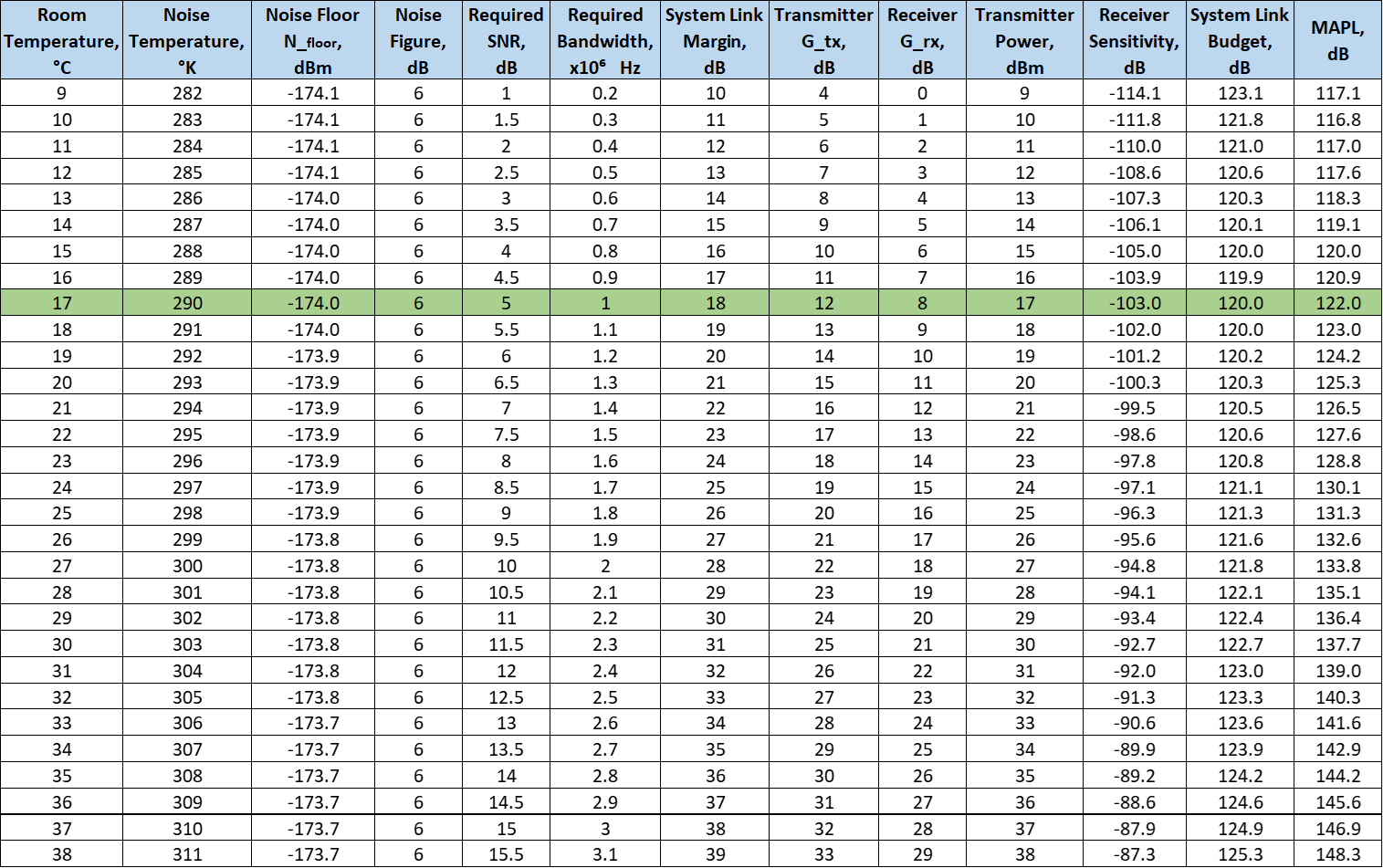

  1. Find USRP-2954 Noise Figure NF = 6dB, and consider BW = 1MHz, SNR = 5dB for 64QAM modulation with 5% BER,
  2. Calculate the sensitivity using the formula given in step 1. Sev = -174 + 6 + 10xlog(1,000,000) + 5= -103dBm

  3. Calculated system link budget with formula S_LB = Tx_pwr - Sev
          S_LB = 17 - (-103) = 120dB

  5. Calculated maximum allowable path loss (MAPL) with formula MAPL = S_LB + G_tx + G_rx - LKM
         MAPL  = 120 + 12 + 8 - 18 = 122dB

Here we summarize the calculated results in below table, high lighted row is the summary of the results discussed in above steps.
