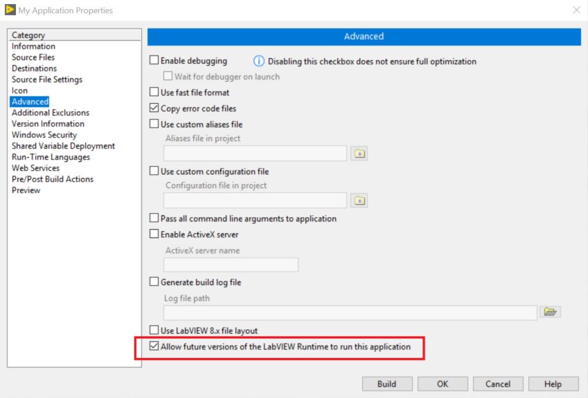

The applications built in LabVIEW always require the same Runtime Engine version of the LabVIEW where the applications have been built.
One exception is if we allow future versions of the LabVIEW Runtime to run the applications.
To do so, you need to open the
Application Properties Dialog Box, select "Advanced" from the shortcut menu and tick the "Allow future versions of the LabVIEW Runtime to run this application" option.
