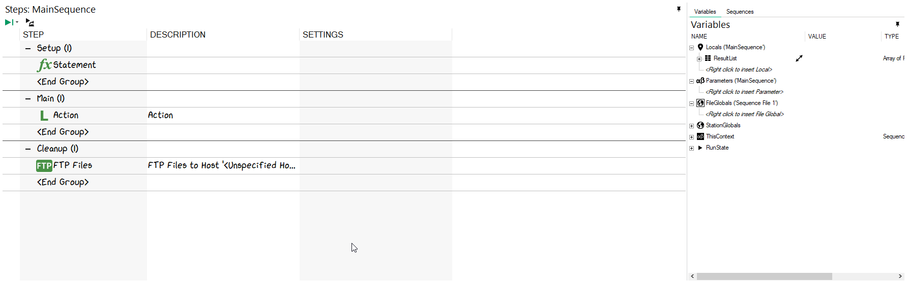

After following the steps to edit the text appearance, there is now a custom appearance of text in the Sequence Editor or Execution viewer:
