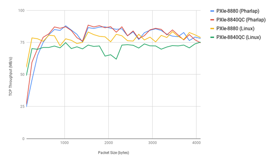

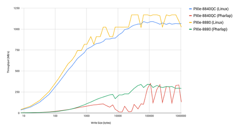

Check Network and Disk Throughput
As noted in the overview, NI LinuxRT Ethernet and disk throughputs are significantly improved from Pharlap. See below for sample test results from NI performance benchmark tests.
Comparison of network throughput test running on LinuxRT versus PharLap
Figure 1: Comparison of network throughput test running on LinuxRT versus PharLap
comparison of disk write throughput test running on LinuxRT versus PharLap
Figure 2: Comparison of disk write throughput test running on LinuxRT versus PharLap
