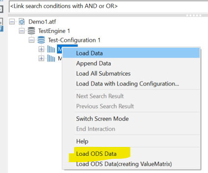

After the script is executed, the option “Load ODS Data” will be enabled in
Context Menu

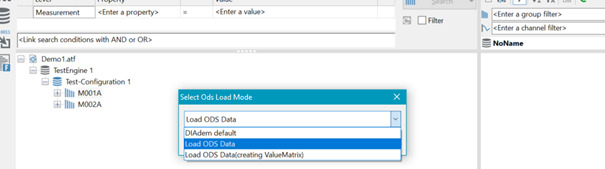

and Drag and Drop
As a result, the submatrices will be loaded in groups by using the option “Load ODS Data”
If you do not want these "NOVALUES" you should load the submatrices and do it without the value matrix.
