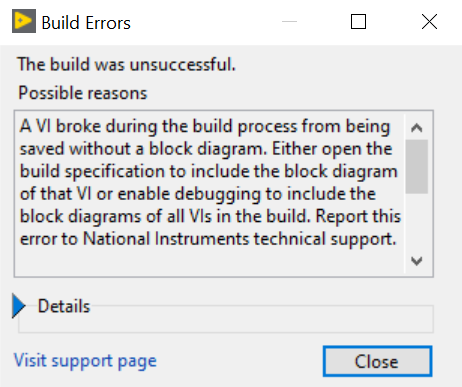

When I am building this VI as an executable file, I receive the following error:
The build was unsuccessful.
Possible reason
A VI broke during the build process from being saved without a block diagram. Either open the build specification to include the block diagram of that VI or enable debugging to include the block diagrams of all VIs in the build. Report this error to National Instruments technical support.
C:\Program Files (x86)\National Instruments\LabVIEW 2020\vi.lib\addons\_NISVFA\_Generation\Signal Generation\SV Signal\Calculate Number of Remaining Samples.vi
error
If I tick Enable debugging in the Advanced category, I can build the executable successfully but the executable has a broken run button.
How can I resolve this issue?

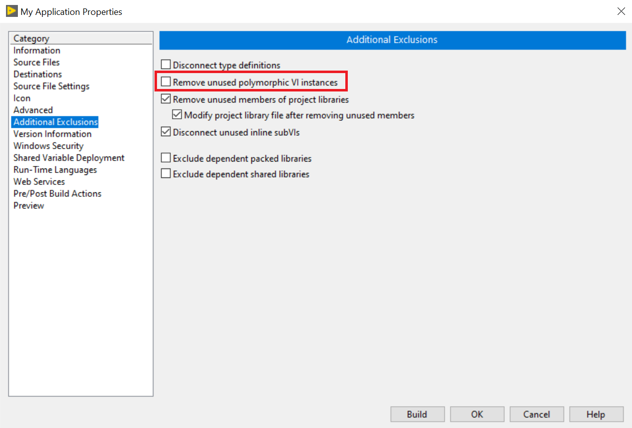

This issue can be fixed by deselecting the Remove unused polymorphic VI instances in the Additional Exclusions category as illustrated by the image below.
This issue occurs because the Sound and Vibration toolkit has a menu item associated with the library and including all items from the library will include a menu item, which does not have a block diagram.
