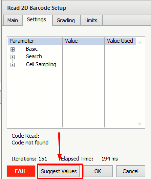

I am using Vision Builder for Automated Inspection to read 2D barcodes, but when I try to read the barcode using the Read 2D Barcode step, the program throws this error:
Algorithm Was Not Able to Locate the Data Matrix or Code not found

  • Use the Suggest Values option, so that the function itself suggests the values of the parameters used in the algorithm.

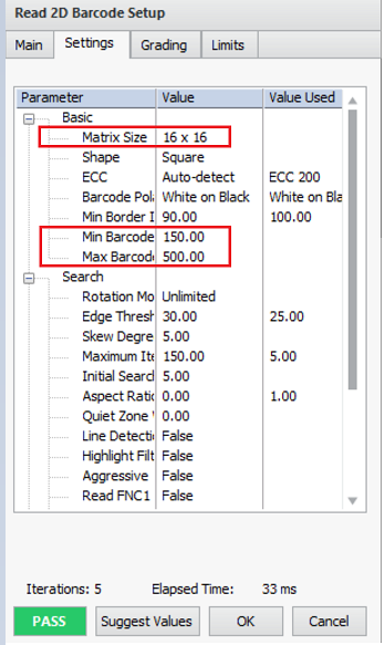

  • If the step still does not read the barcode after using the Suggest Values option, modify the settings of the step manually until you find a configuration that works. For instance, if you already know what is the expected size of the matrix, you can help the algorithm by specifying the matrix size. You can also specify the minimum and maximum expected barcode size in pixels, so that the algorithm never excludes a matrix candidate because it is too small or too big.
