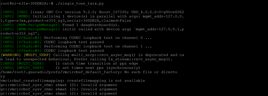

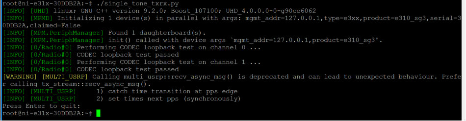

4. Run the script, and the error shown in Figure 2 appears. This error will occur when the Python script is run on the E320 for the first time. Just run the script again, and the error will not be triggered later, as shown in Figure 3.
Figure 2
Figure 3
