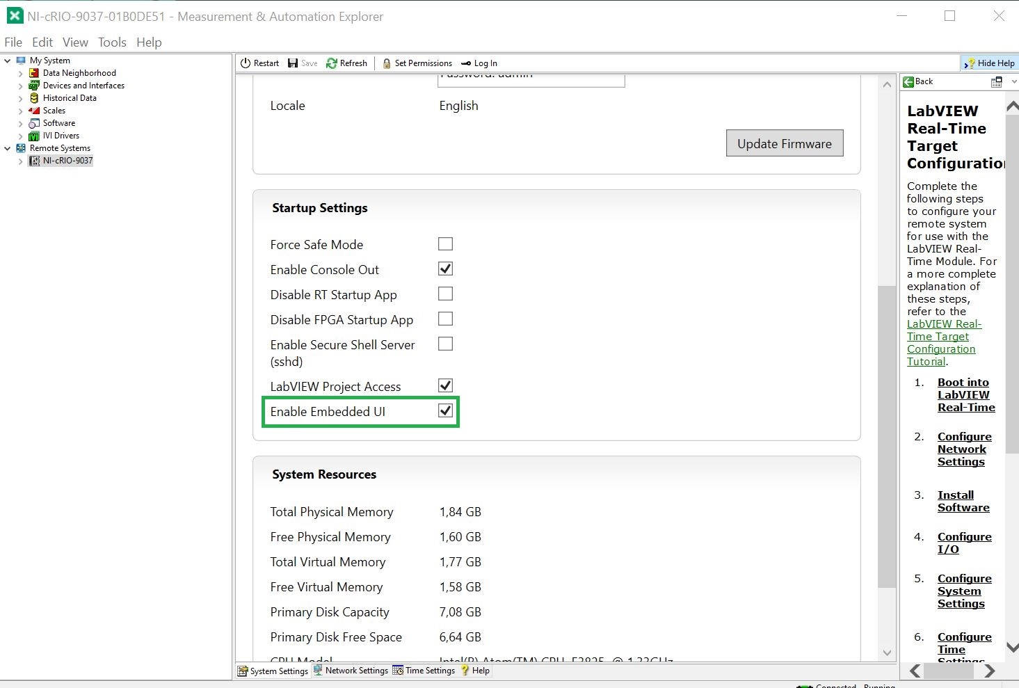

I want to programmatically open Front Panels from different subVIs in my Real-Time Controller for debugging purposes.
The documentation for this method specifies that is possible to use it in an Real-Time Controller.
Verify if the Real-Time Controller supports Embedded UI .
If the Real-Time Controller supports this functionality, you need to enable the Embedded UI option from the Startup Settings of the System in NI MAX.
  1. Select your Real-Time Controller from the Configuration Pane
  2. Select the System Settings Tab
  3. Check Enable Embedded UI option in Startup Settings
Use the FP.Open Method on LabVIEW to open a Front Panel from a subVI in Real-Time Controller.
Next Steps
If LabVIEW shows Error 1043:
Please verify that you saved the configuration in NI MAX and also restarted the Real-Time Controller.
Please note that it is not recommended to use Front Panels in Real-Time Controller due to the limited resources.
It is recommended to use this feature for Debugging Purposes only.
