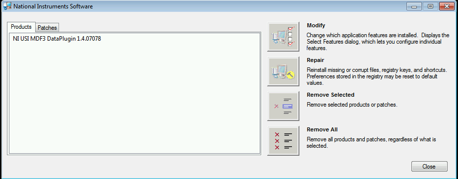

  • If the NI Package Manager is installed on the computer, the DataPlugin should show up under the installed software as follows:
NI Package Manager
  • If the pc does not have NI Package Manger installed, then the DataPlugins will appear in the list of installed products after you select Uninstall/Change for National Instruments software in the windows uninstall control panel. See the photo for an example:
NI Software DataPlugins

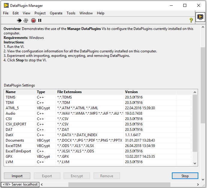

  • You can use a LabVIEW example to verify that the component is installed. Please open the following example. Go to Help >> Find Examples... >>  Fundamentals >> File Input and Output >> DataPlugin >> Manage DataPlugins.vi. Open the example and run it, this will show us a list of the installed DataPlugins in your pc. Please check if the desired data format is listed as in the following picture:
DataPlugin Manager Example
