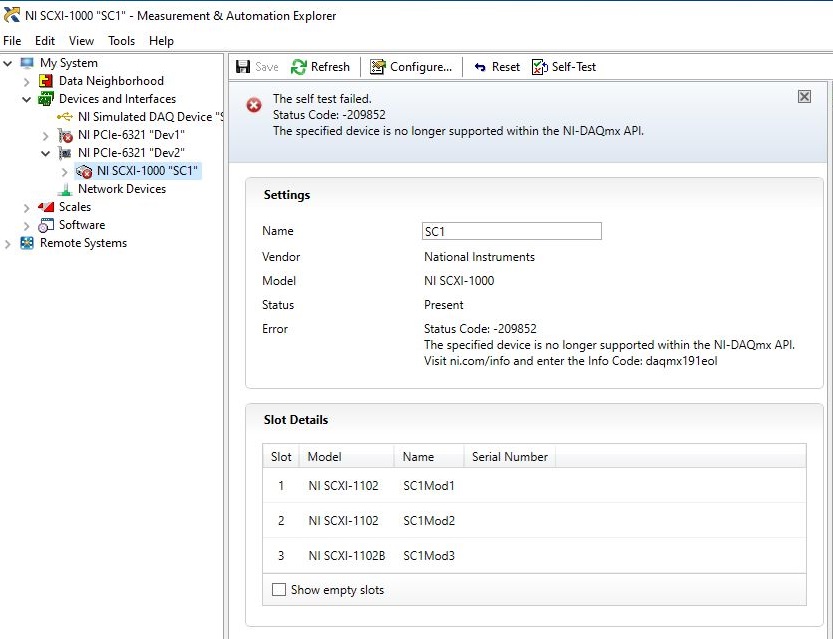

I'm connecting SCXI chassis to my PC in NI MAX, when I try to do Self-Test it prompt the error code below and the self test failed.
Status Code: -209852
The specified device is no longer supported within the NI-DAQmx API.
Visit ni.com/info and enter the Info Code: daqmx191eol
SCXI chassis and modules are supported until NI DAQmx 19.0 , if you are using the latest version of NI DAQmx please uninstall and reinstall NI DAQmx 19.0 or below.
