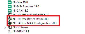

The Data Neighborhood and Scales sections in NI MAX are likely missing due to your LabVIEW installer not installing NI-DAQmx Configuration Support, which is required to configure tasks and scales in MAX. You can confirm this by going to the
Software tab in NI MAX, and checking to see if both NI-DAQmx Device Driver
and NI-DAQmx MAX Configuration Support
is present
If you only have NI-DAQmx Device Driver, then you need to add NI-DAQmx Max Configuration, this package is added when the NI-DAQmx Runtime with Configuration Support is installed. To install this you can follow next steps:

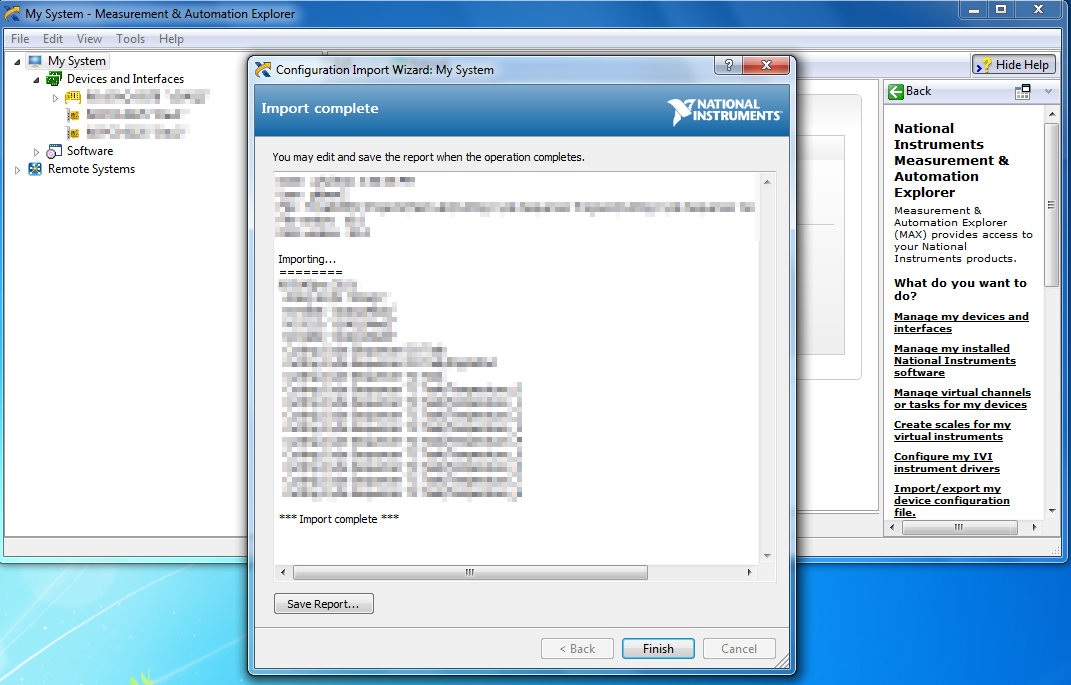

Another solution you can perform is including configuration support in your installer by editing your installer build specification in your LabVIEW project.
- In the Installer Properties Dialog Box for your installer, select Additional Installers from the categories on the left and ensure that NI-DAQmx Runtime with Configuration Support is one of the selected installers listed in the window.
- After adding the NI-DAQmx Runtime with Configuration Support installer, rebuild your installer.
- Uninstall the software currently installed on your deployment machine and re-run your new installer on your deployment machine.
You should now be able to correctly import and configure tasks and scales for your hardware in NI MAX.
