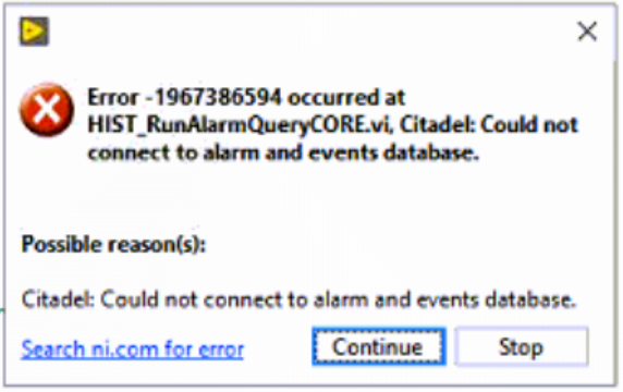

Errors When Try to Access to Events and Alarms in My Citadel Database
Updated Jun 6, 2023
I want to access to Alarms and events in my database, but I am receiving the errors -1967386611 and -1967386594 when I try to access. What can I do?

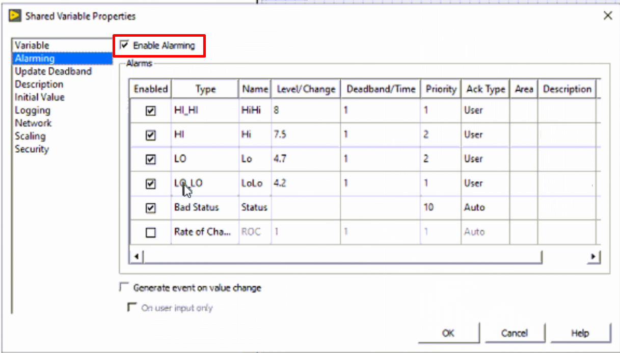

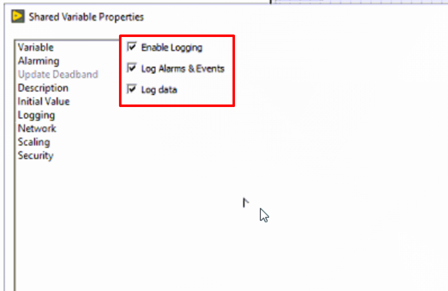

  • Be sure to enable Logs Alarms & and Events

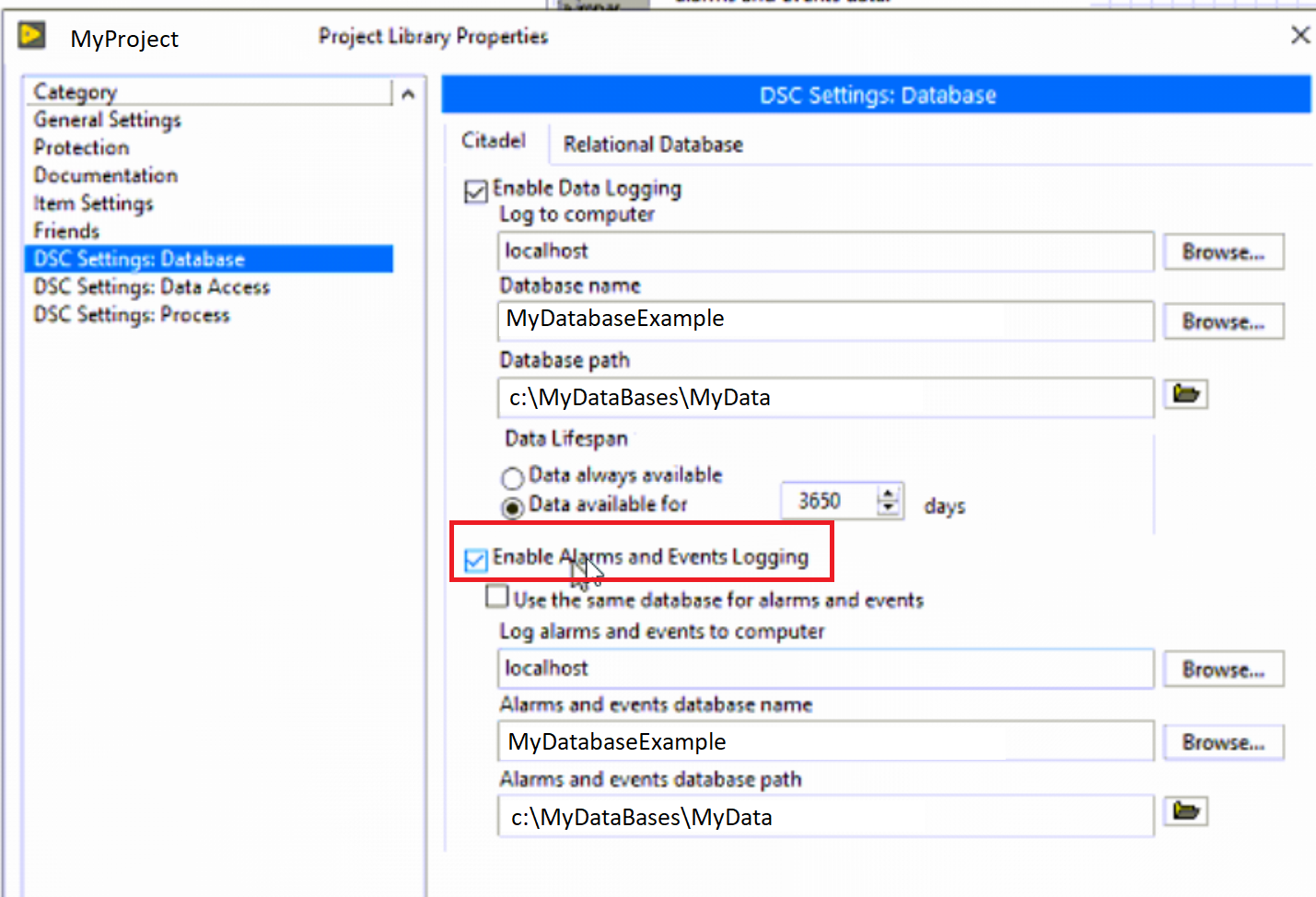

  • Be sure to Enable Alarms and Events in the DSC Settings: Database, in the Project Library Properties

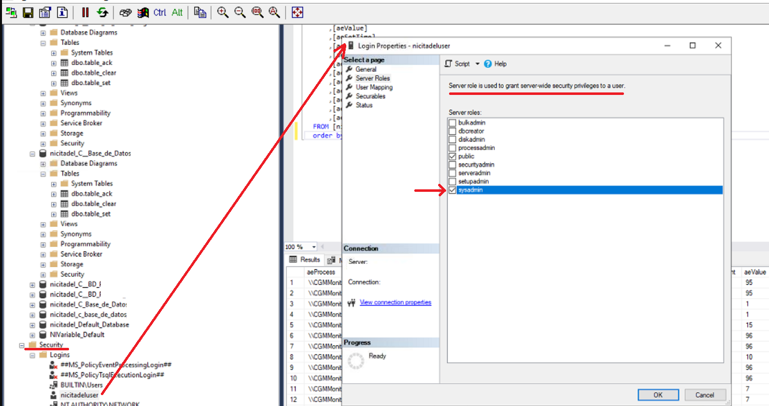

  • Use the Server SQL Manager, Security, Server Roles to activate the right role for the user NICitadeluser
Now the database for Events and Alarms must be accessible to read
