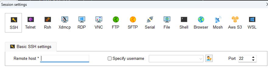

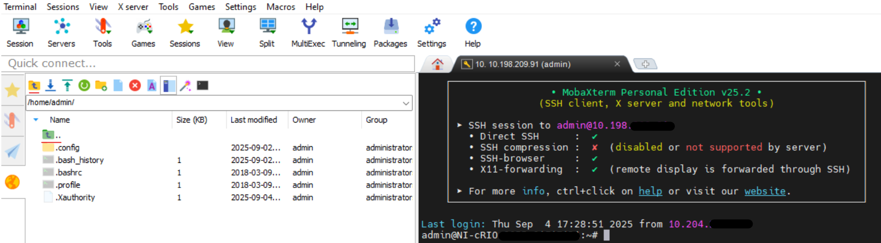

MobaXterm via SSH
MobaXterm provides an interface to create session via SSH or other protocols to network devices. For file transfer and navigation, MobaXterm provides access to files and the terminal of the RT Target.
To connect to your target using MobaXterm:
  1. Click on Session, this will open the Session settings.
  2. Click on SSH
  3. Input the Basic SSH settings, input the Remote host (IP address of your target) and click on Specify username (Input your username and password if required).
  4. Click OK
  5. Navigate thru the file tree, click on the file with an up arrow to move to the parent directory.
  6. To move files to your target, drag and drop the corresponding file from the file explorer to the directory in your target.
Note: MobaXterm is a 3rd party software product; as such, this product is not supported by NI Technical Support. For assistance with MobaXterm, please post to the forums on MobaXterm's website.

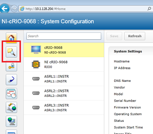

Web-based Configuration
File system access is also possible via the web configuration tool. This can be accessed by simply navigating to the IP address of the cRIO in the URL bar in Internet Explorer and selecting the Remote File Browser button, highlighted in the image below. A few items of note:
  • The Web-based Configuration and Monitoring software needs to be installed on the cRIO.
  • A non-blank password is required for the admin user on the cRIO.
  • File system access is done through the lvuser user account, not admin. Attempting to modify files that lvuser does not have access to will result in a "403: Forbidden" error message.
The buttons at the top of the file system window will allow you to navigate and manipulate the files on your Linux Real-Time target.
Note: Internet Explorer and Silverlight are no longer supported by Microsoft. This older version of the Web-Based Configuration and Monitoring tool relied on Microsoft Silverlight and is no longer supported by NI. A new Web-Based Configuration and Monitoring tool for NI Linux Real-Time targets was released with the NI Linux Real-Time System Image 21.0, but the new version of the tool does not include file access.
