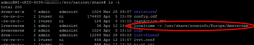

In order to change a NI Linux Real-Time controller timezone you have to access to the device shell.
In order to do this, access the shell of your device following the steps given in the article "Accessing the Shell on NI Linux Real-Time Devices" and then follow these instructions afterwards:
  1. cd /etc/natinst/share to move to the "/etc/natinst/share" folder
  2. Optional: ls -l to display the link to the current timezone used.
  1. rm localtime to delete the current link to timezone information.
  2. ln -s /usr/share/zoneinfo/Europe/Berlin localtime to set the desired timezone (in this example Berlin/Europe timezone is used). The new setting is immediately active, no restart needed.
  3. Optional: ls -l to verify the new timezone link was successfully created.
  4. Optional: date to show the current system's time.
The list of the possible timezones is contained in the path /usr/share/zoneinfo/​
Use ls /usr/share/zoneinfo to explore the highest level, and e.g. ls /usr/share/zoneinfo/Europe to explore a subfolder, accordingly.
You may need to press the Refresh button on NI Measurement & Automation Explorer (MAX) to display the new timezone
You can verify that the timezone shown in NI MAX is aligned with that set on the device by using the date command in the shell.
