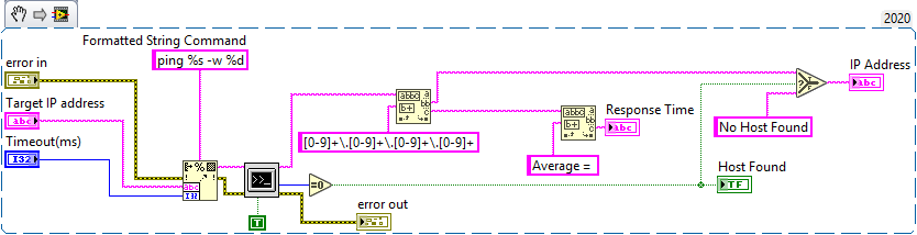

There is no way to define a specific timeout for this function. However, there are some workarounds that you can consider:
Using these options before the Open FPGA VI Reference function will implicitly set up a timeout.
