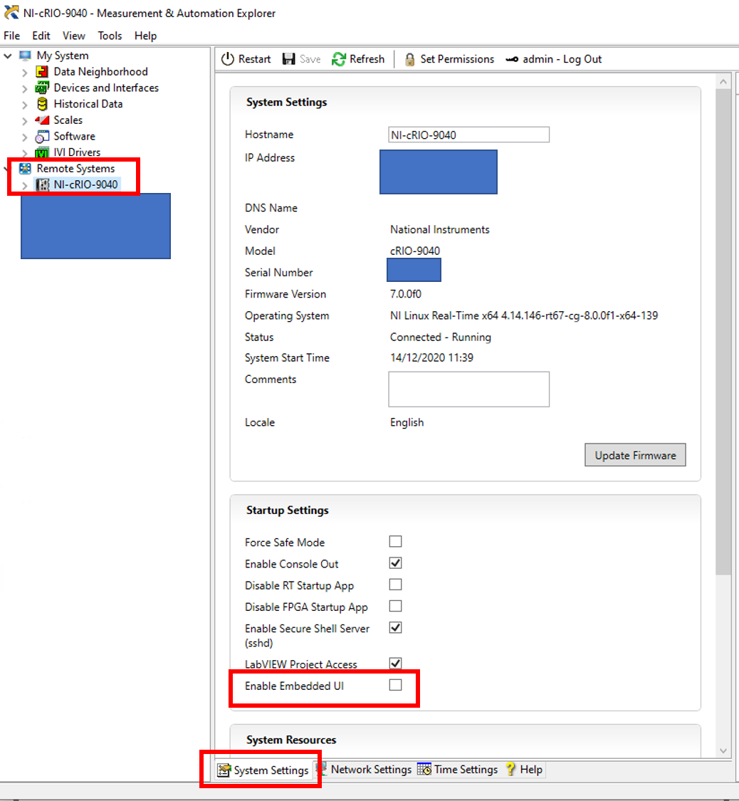

1. Disable the embedded UI option in NI MAX
  • Open NI MAX.
  • Expand Remote Systems in the configuration tree, and then select your RT target.
  • In the Startup Settings section of the System Settings tab, remove the check from the checkbox to disable the Enable Embedded UI checkbox.
  • Click Save, and then Yes when prompted to restart the target.
    Tip:  You also can enable the embedded UI checkbox using NI Web-based Configuration & Monitoring.
